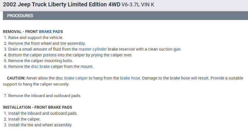

The front brakes make noises while I am driving. Let's say that after decelerating, the grinding starts I think I need new front brakes and rotors can you help?

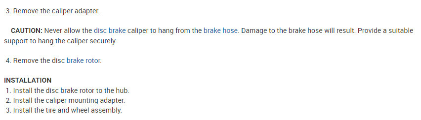

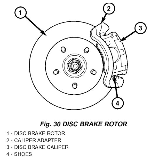

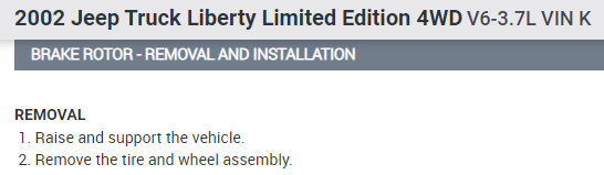

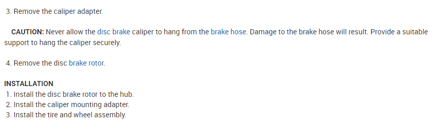

Here is the information you requested. Here is a tutorial for you to view on how to change front brake pads and rotors:
I've attached picture steps below on how to change the front brake pads and rotors on your Jeep. Hope this helps and thanks for using 2CarPros.
