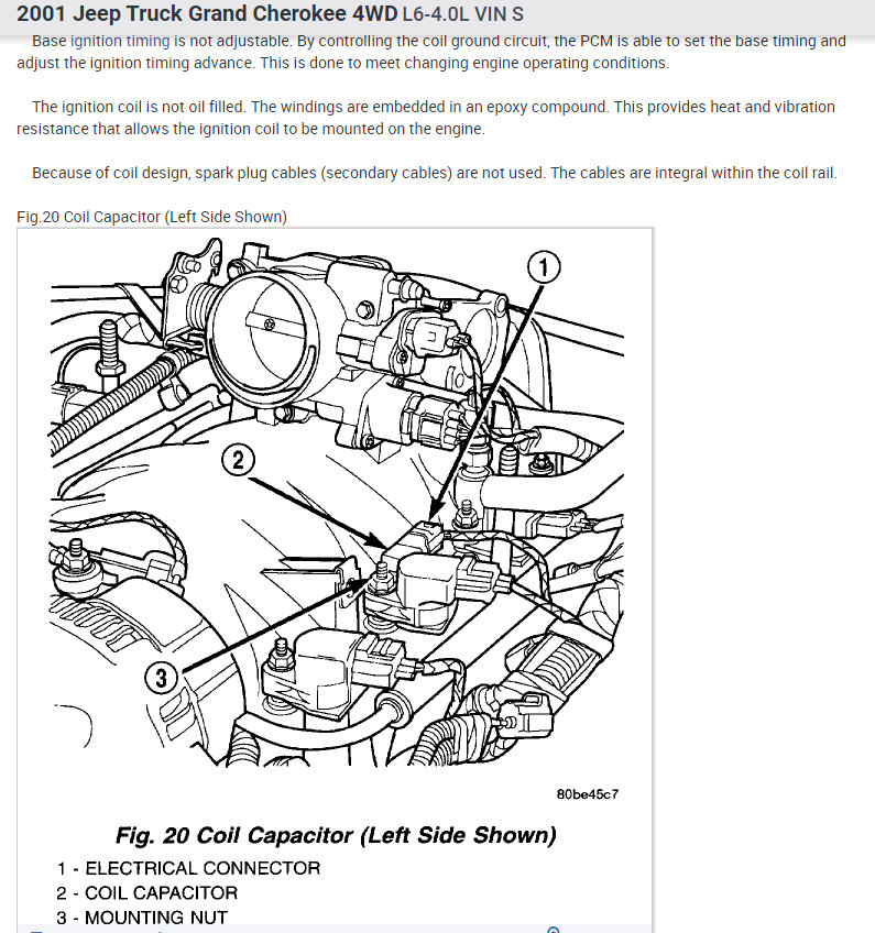

When you get a misfire code, it could be due to a spark plug or the coil, it can also be due to the ignition control module. This Jeep also have ignition coil capacitor. Those can also trigger the misfiring.

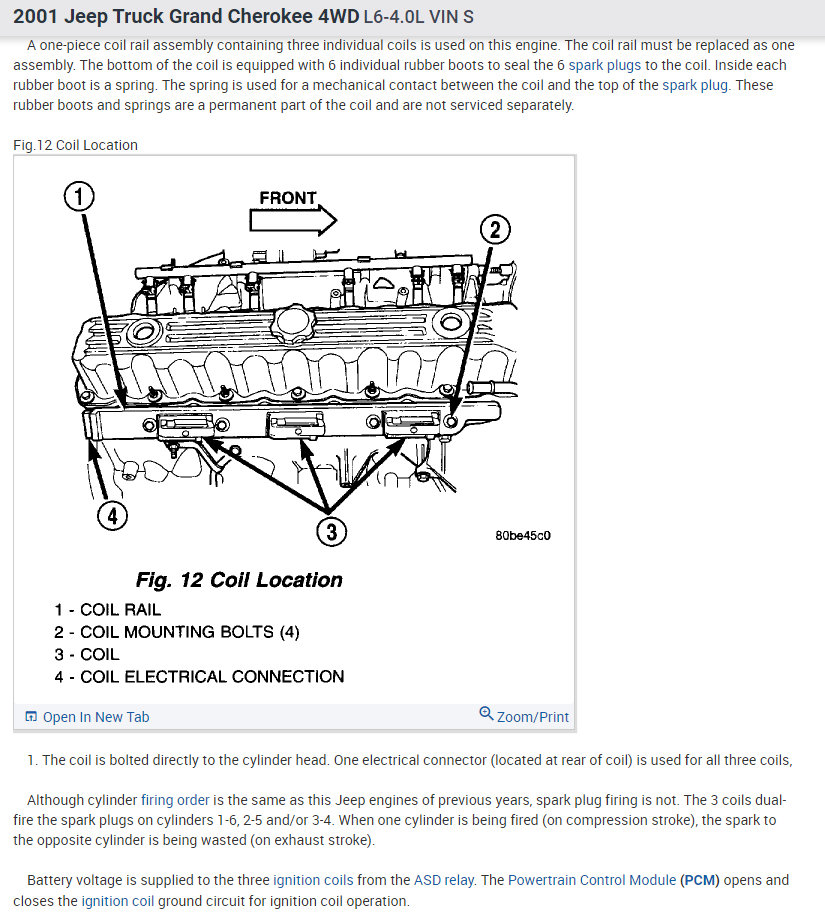

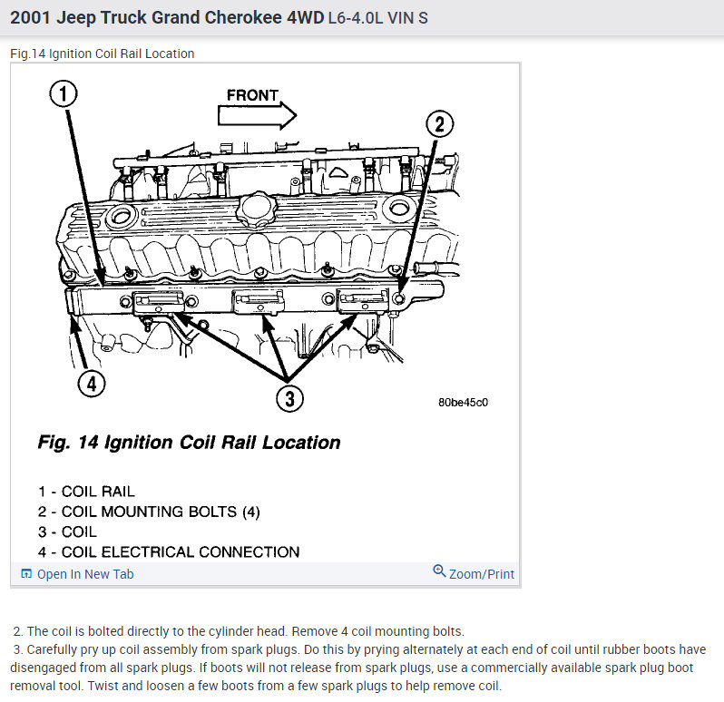

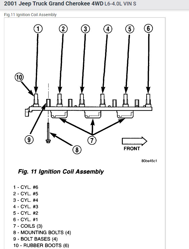

If you have to replace the coil pack, it has to be replace as a complete unit for all six cylinders.
