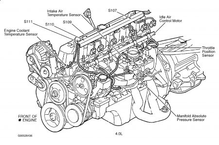

Where is located the IAC Valve, I think I have a problem with this, when I start on mornings or with the jeep cold by the first time I need to keep the acelerator on 1000 rpms by 1 minut around because if I remove my foot the truck turns off after the minut the truck runs perfectly

thanks then the idle air control motor is the valve iac???

  • 75,992 POSTS
Same purpose, different names-could be ISC

ok but I'm looking the IAC Valve can you tell me where is it?

  • 75,992 POSTS
The IACV is the same as the Idle air control motor its on the pic I've given you earlier

ok tank you the I'm going to change as son as posible because when I start the engine on mornings I need to keep my foot 1 minute on the acelerator because if I leave to acelerate the jeep is turn off the rpm's comes low
