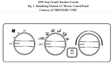

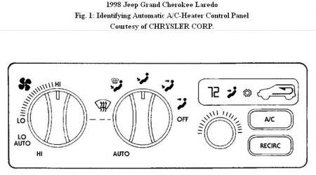

I don't know what this means HVAC system? so I don't know if it's manual or auto

HVAC is an acronym that stands for the closely related functions of "Heating, Ventilating, and Air Conditioning" First diagram shows an automatic HVAC control panel.
https://images.2carpros.com/forum/automotive_pictures/192750_HVACControlPanelAuto98CherokeeLaredoFig01_3.jpg
https://images.2carpros.com/forum/automotive_pictures/192750_HVACControlPanelManual98CherokeeLaredoFig01_1.jpg

Mine is NOT automatic HVAC we call automatic HVAC "Climate Control". and the motor is a 6 cylinder 4ltr. What is a blower motor? is that the heater fan? thanks

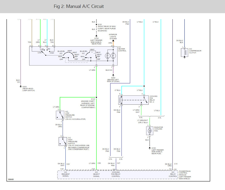

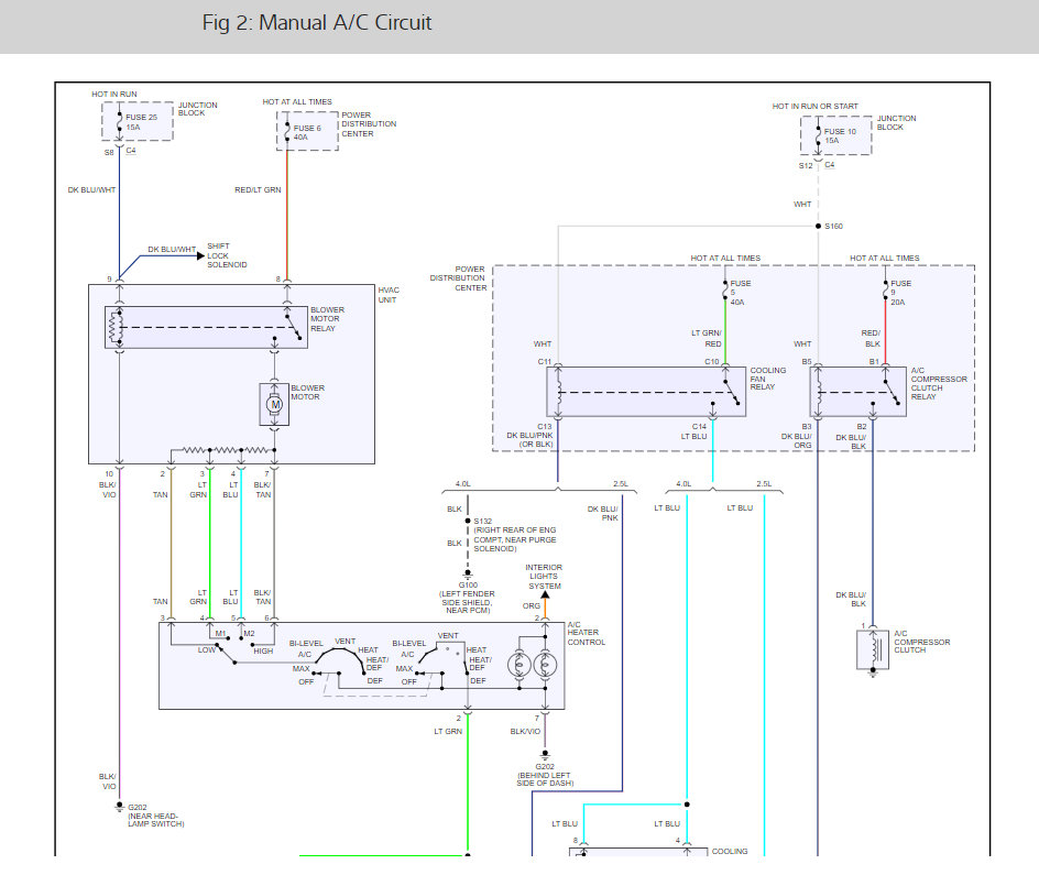

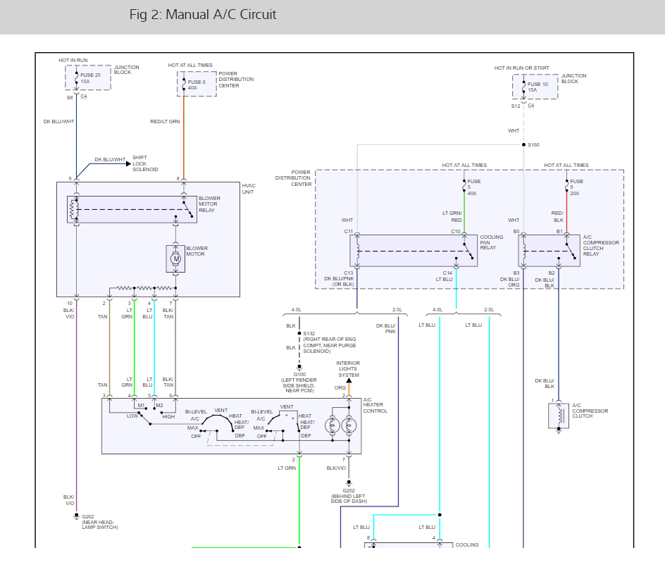

To check for a bad gound, the easiest way is to use an ohmmeter. Push probe to a well grounded location and use the other probe on any ground wire that you wish to test. Anything more than 1 ohm should be cleaned and retightened.
It might not be a ground circuit connection but a faulty Power Control Module or a leaking vacmun line.
The A/C compressor relay is activated by the PCM and if it is kicking n and out, the PCM is either faulty or it is getting the wrong signal from somewhere.
The heater fan should not turn the compressor on unless it is shorted to the circuit.
Here is a wiring schematic. Note the location of the ground circuits that should be checked. Check out the diagrams (Below). Please let us know what you find.
