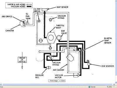

i found a new problem. my engine has low vacuum at idle. its only getting 14.5 to 15 hg. could this be a sign of a partially clogged cat?
Oct 25, 2008 at 11:25 AM
JNOVACK
  • 723 POSTS
here is a diagram of your vaccum system check all hoses for cracks or getting cloged
https://images.2carpros.com/forum/automotive_pictures/52960_vaccum_1.jpg
Oct 25, 2008 at 12:02 PM
VERN8650
  • 15 POSTS
that diagram is somewhat close to mine. but i did check my vavuum lines and all were good. the only reason im thinking the cat is because the engine sometimes lacks power and it sounds the engine chokes down then picks up.
