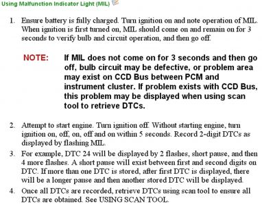

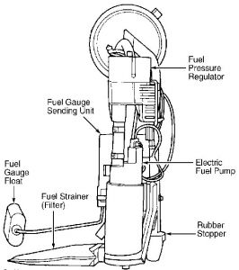

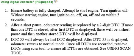

I wouldn't expect that regulator is a problem as the pressure is in spec. The regulator is a mechanical device that works by springs and a diapham. It comes as a module
https://images.2carpros.com/forum/automotive_pictures/30961_jeepmod_1.jpg
I would still like to try to get a code check if possible.
https://images.2carpros.com/forum/automotive_pictures/30961_jeepdlc1_1.jpg
https://images.2carpros.com/forum/automotive_pictures/30961_jeepdlc2_1.jpg
The DLC fuse is a 20 amp that is in the junction box under the right side of the dash. Fuse # 7 It may end up being the pcm, but They aren't real common for going bad...and they are pricy.
