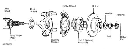

im trying to take off to replace the bearings in my front driver side axle how do i do this i dont have a book

HUB & BEARING Removal Raise and support vehicle. Remove wheel, caliper and rotor. Remove cotter pin, nut retainer, hub nut and washer. Remove hub-to-knuckle bolts. Remove hub from steering knuckle. Installation Apply wheel bearing grease to hub bore in steering knuckle and install hub and bearings. To complete installation, reverse removal procedure. NOTE: Hub bearings cannot be serviced. If defective, replace complete hub assembly.
