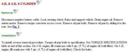

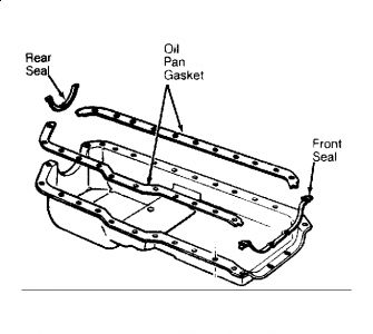

How can I remove the oil pan? I am having trouble removing it to replace the oil pan gasket, other parts are in the way of it coming out.

Hi there, See text & pic for sump removal, mark (mhpautos)
