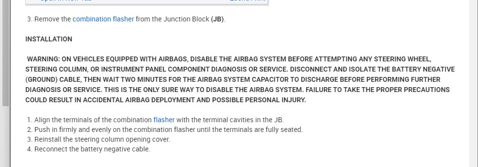

I am trying to replace the turn signal flasher
90,000 MILES • V8 • 4WD • AUTOMATIC
JEFFERY78
  • 5 POSTS

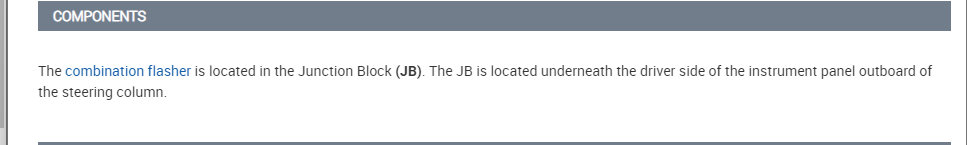

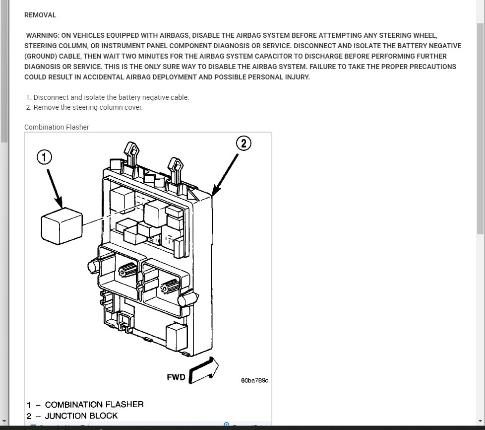

I am trying to replace the turn signal flasher and I have read it's in a tight place behind the kneeboard. I have take 2 screws off the bottom and 1 from the left side of the kneeboard. The kneeboard is still snug and i'm not sure what is holding it in place. I don't know if it is clips holding it in place or if I need to take more of the dash apart? Thank you for any tips you can give.
Oct 24, 2010 at 5:10 AM

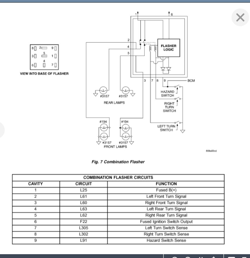

This is in the junction block that is behind the steering column. I am attaching the process below on how to replace this.
Here is a guide that will help with this issue:
https://www.2carpros.com/articles/turn-signals-not-working-blinker
Please see the attached info below and let me know what other questions you have on this.
Thanks
