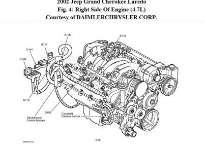

Wheres to find the p0340 sic. On eng

My info shows this for the cam sensor location. If that is what your asking?
