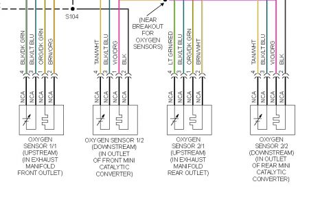

where is the oxygen sensor located in my jeep grand cheeroke?

Which one are you talking about? They are in the exhaust.
https://images.2carpros.com/forum/automotive_pictures/170934_cherokee_02_sensor_1.jpg
