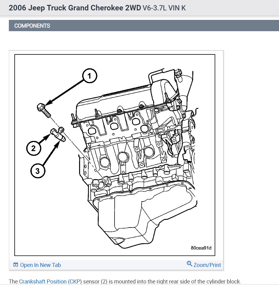

Shut off while driving and will not restart
2006 JEEP GRAND CHEROKEE
195,000 MILES • 3.7L • 6 CYL • 4WD • AUTOMATIC
TAMMYWINTERCAPEN
You can fuel pump working. It's firing wants to start and won't.

It sounds like the crankshaft sensor has gone bad, but we should run the codes first. This guide will help. Also, I can see if the engine is in good shape if you upload a short video of the engine cranking, here are some helpful guides as well with the crankshaft sensor location in the diagrams below:
and
https://www.2carpros.com/articles/car-not-running-advanced
