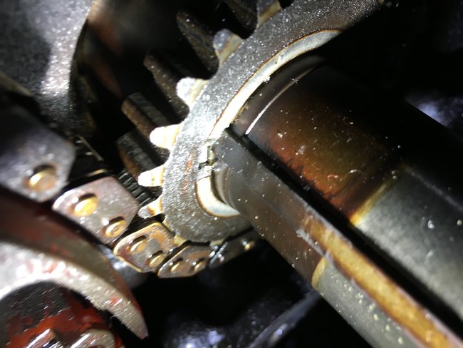

Just an update here. Timing chain gear broke.
Dec 9, 2018 at 5:00 AM
Experienced Mechanic
52,796 POSTS
Oh, sorry to hear that.
Most likely you have damaged valves from that issue. Then I would like to know what caused it to break. They do not just break for no reason.
I would be ready to consider changing the engine at this point.

Picture.
Image (Click to enlarge)
Dec 9, 2018 at 6:03 AM
DALTON59
MEMBER
12 POSTS
Think it is called the key way.
Dec 9, 2018 at 6:04 AM
52,796 POSTS
Yes, that is correct.
