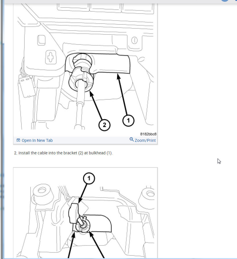

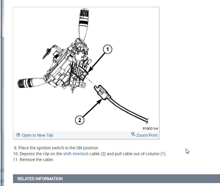

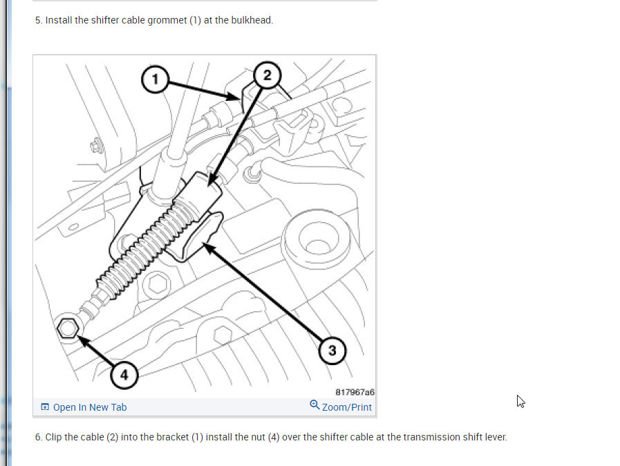

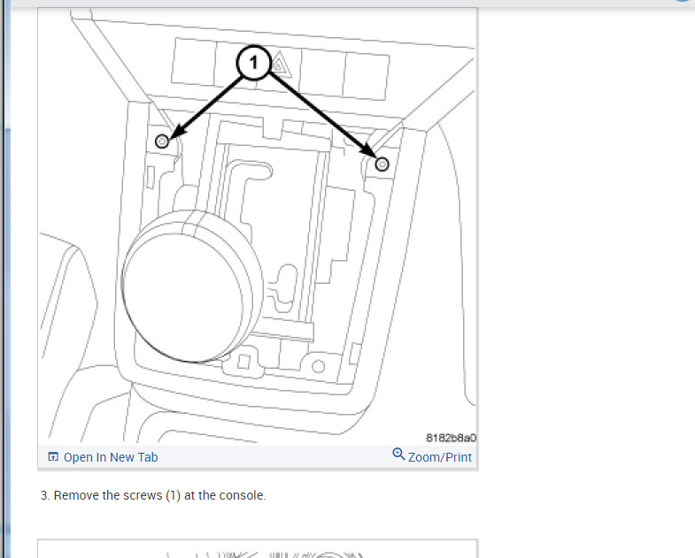

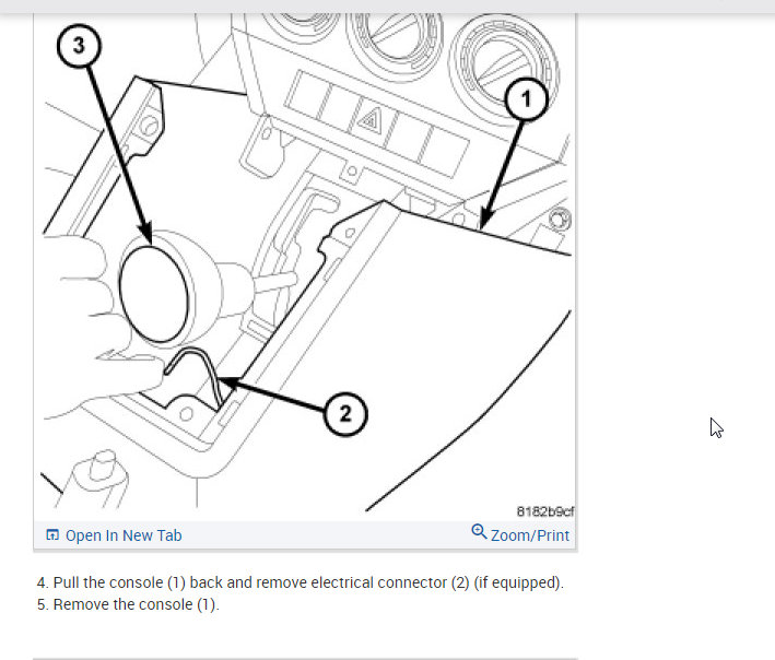

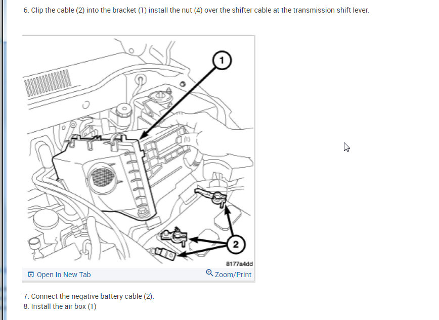

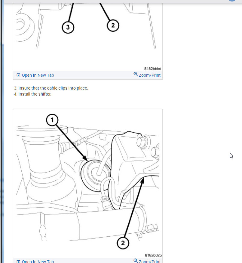

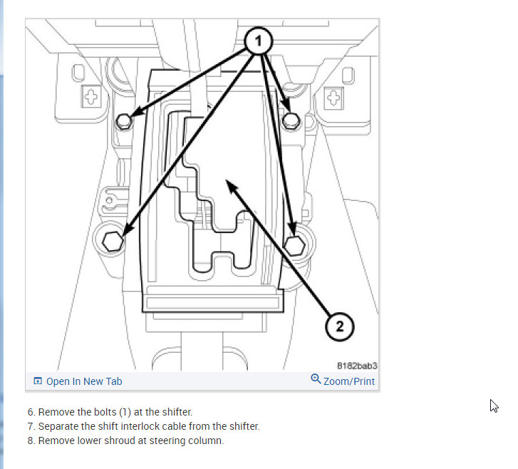

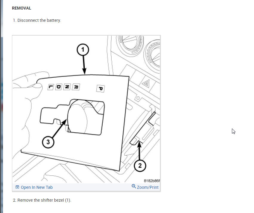

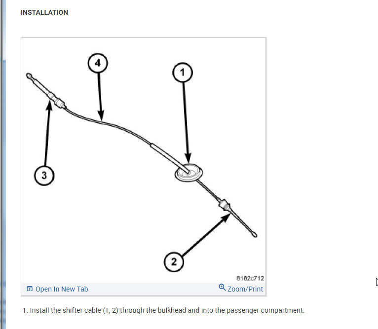

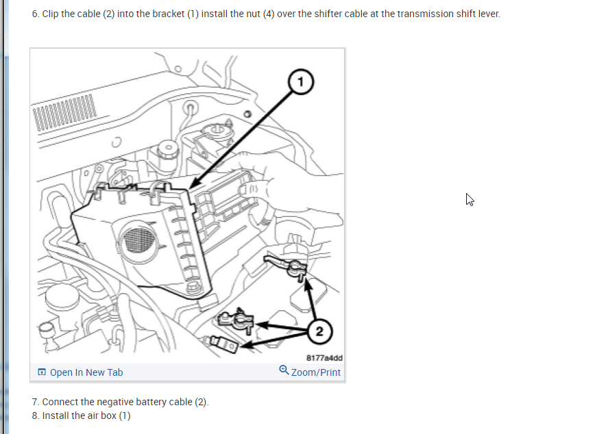

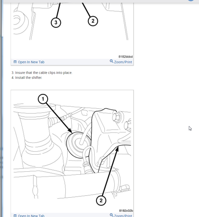

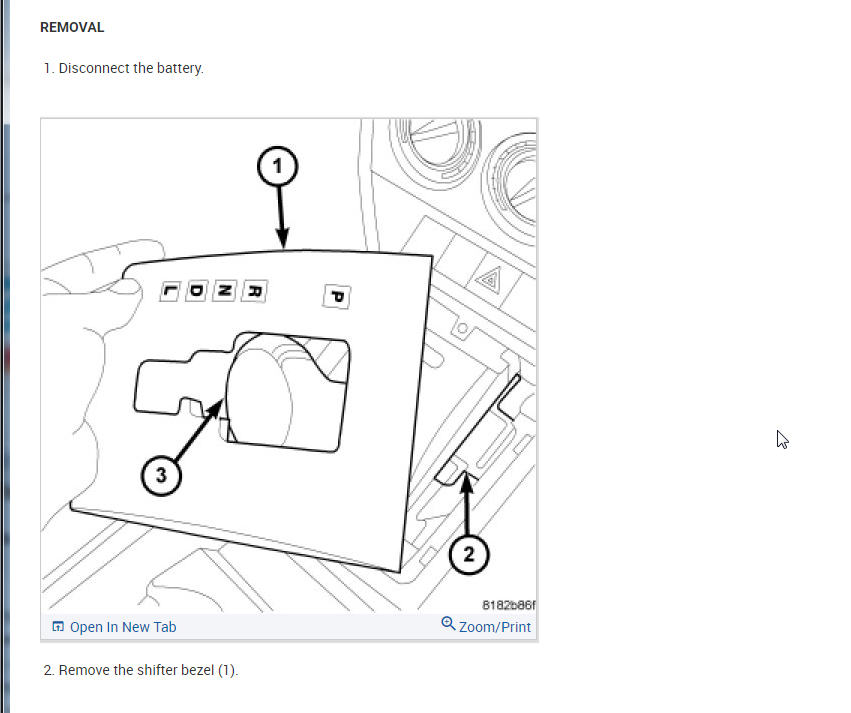

Transmission won't go into reverse because cable snapped broke the gears are working it snapped just under gear stick.
May 5, 2021 at 2:00 AM
If the cable snapped then you will have to replace it. I attached the info from the manual on how to replace this from the manual. Please run through this material and let us know if you have other questions. Thanks
