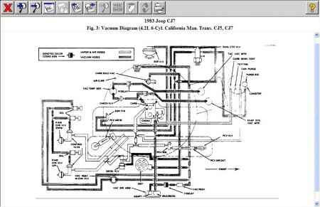

1983 Jeep CJ7 vacum hoses
1983 JEEP CJ7
137,223 MILES • 6 CYL • 4WD • MANUAL
TIME2PLAY
Need diagram of where vacum hoses are suppose to go.Most were gone when I got the Jeep.

See below
https://images.2carpros.com/forum/automotive_pictures/12900_vac_lines_2.jpg
