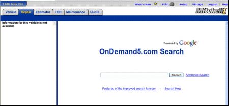

Hello - I apologize the answer didn't meet your expectations. I have attached the pic of shop manual we refer to. As it says, "Information for this vehicle is not available." Which from what you stated.......your manuals don't provide the answer either.
https://images.2carpros.com/forum/automotive_pictures/248015_Jeep_1.jpg
There are various vehicles we deal with that the manufacture doesn't release certain technical information. That is beyond our control. In this case the manufacture doesn't release ANY information on this vehicle.....not even the tire pressure......... I wasn't trying to impress you with my reply, only assist you with your problem as we do many customers. I felt being honest with you letting you know that our manuals didn't have any info on your vehicle was the right thing to do. Yet at the same time offer some assistance to your problem. I recently worked a similar problem with a vehicle; though that vehicle had plenty of information in our manual it too didn't address the linkage. However, the linkage was out slightly...........thus you turn the key..........the car continued to run, as yours. They adjusted the linkage and it worked fine. Please let us know what you find out so the other readers may benefit from your information............ I will also refer your input to our supervisor so he too is advised of the situation. Thanks and I hope you have a good weekend.
