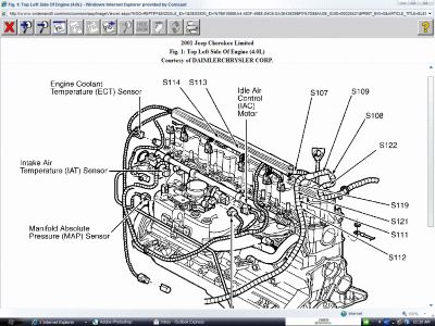

2001 Jeep Grand Cherokee, 73k miles, 8 cyl
Engine surges when starting cold. Most recent problem was a faulty oil pressure sensor, which was replaced .... surge still persists. Once engine warms up a little, the surge goes away!

Check the electronic coolant temp sensor, and air intake temp sensor.
https://images.2carpros.com/forum/automotive_pictures/62217_sensors_1.jpg
