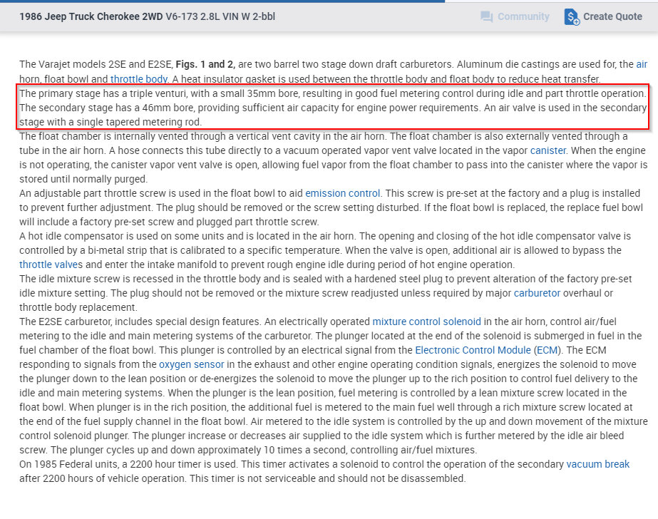

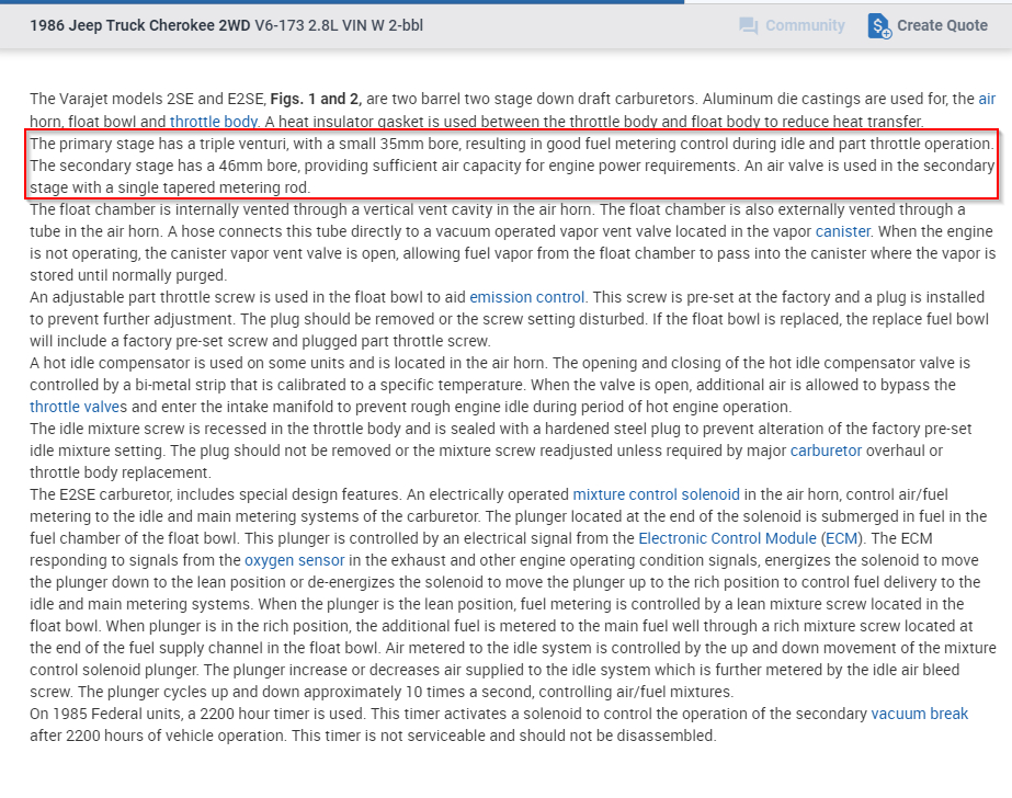

I have seen this from time to time on different types of 2 bbl carburetors. Basically the primary side having a smaller fuel bore (35mm) gets clogged up with more modern fuel. Keep in mind these vehicles were designed to run on non ethanol fuels. So when that is introduced into these vehicles and the fuel evaporates it leaves a residue behind and it causes all sorts of idle issues especially during warm up.

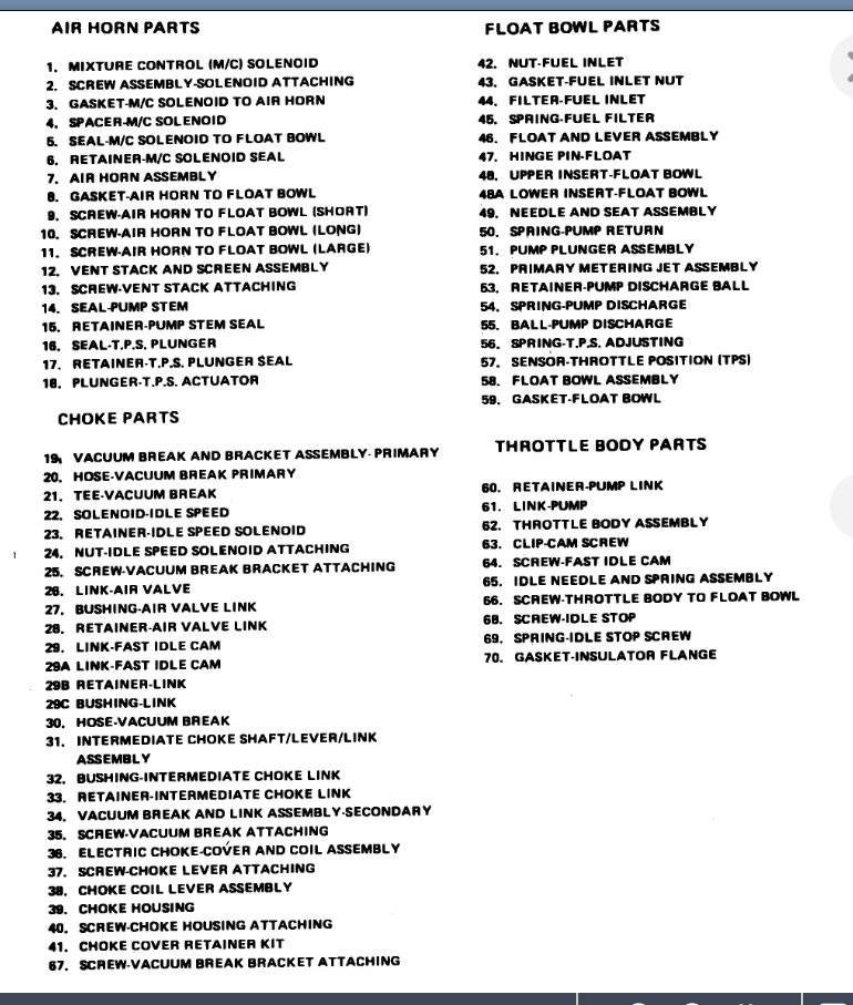

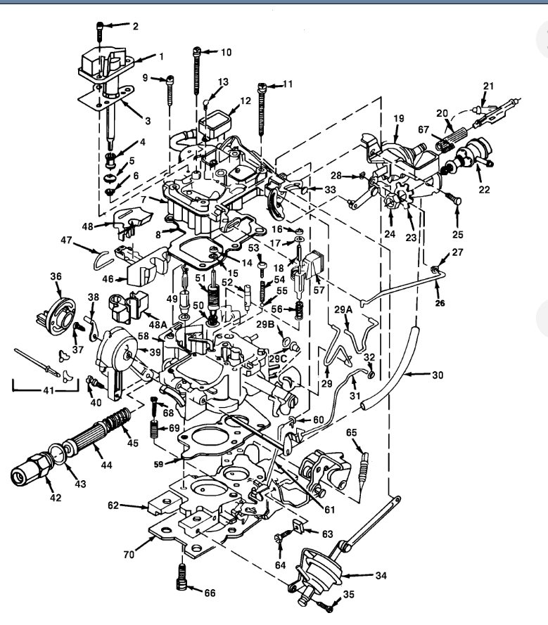

I would suggest removing the carburetor and rebuilding it to clean it out and I am sure this issue will be resolved. I included the exploded view for your reference to assist with the reassembly.
