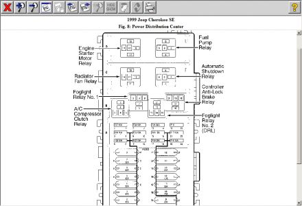

I just need to find a diagram of the fuels relays in a 1999 Jeep Cherokee with about 125,000 mi 4WD 6cyl I don't know if you have a good website to go to to get one?

Here ya go!
https://images.2carpros.com/forum/automotive_pictures/47722_cherokee_1.jpg
Let me know if this helps! Chris
