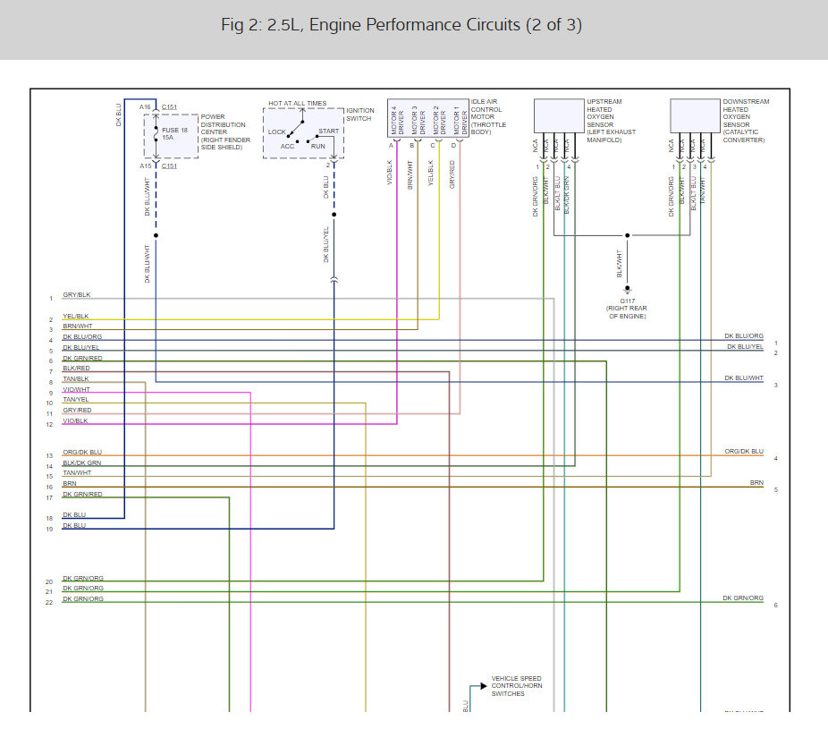

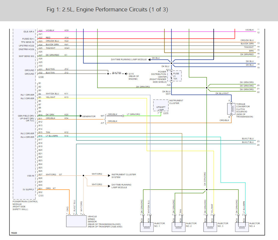

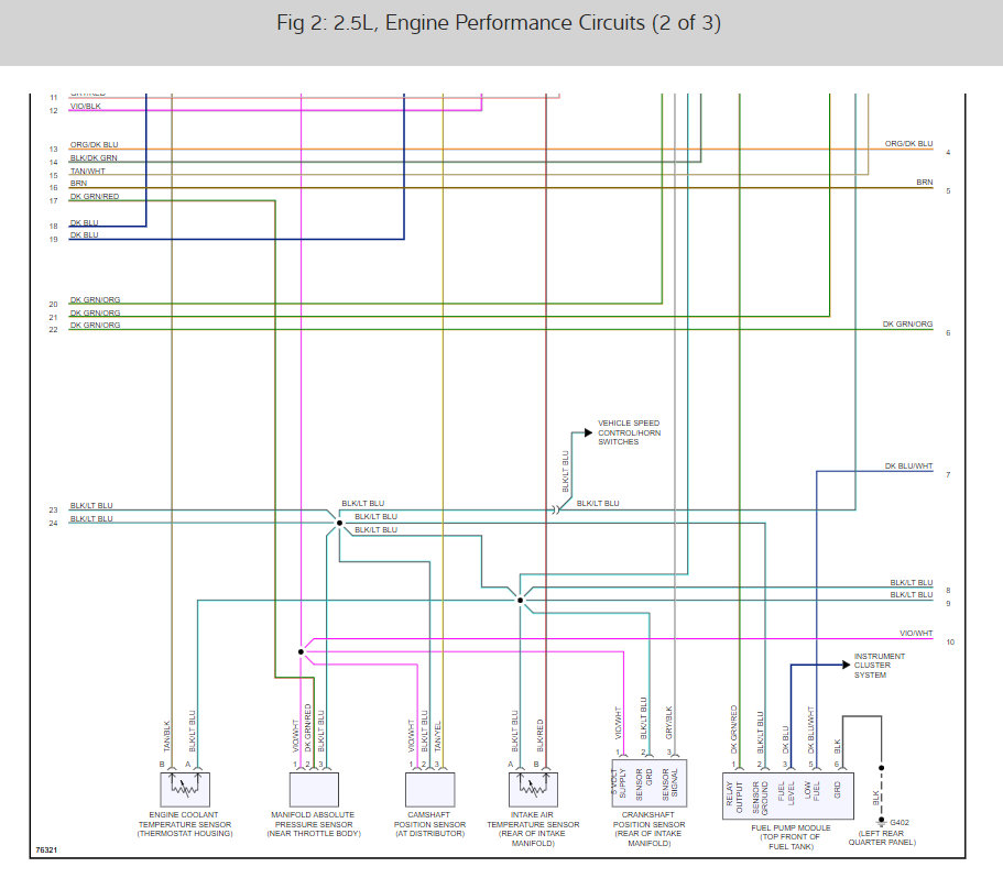

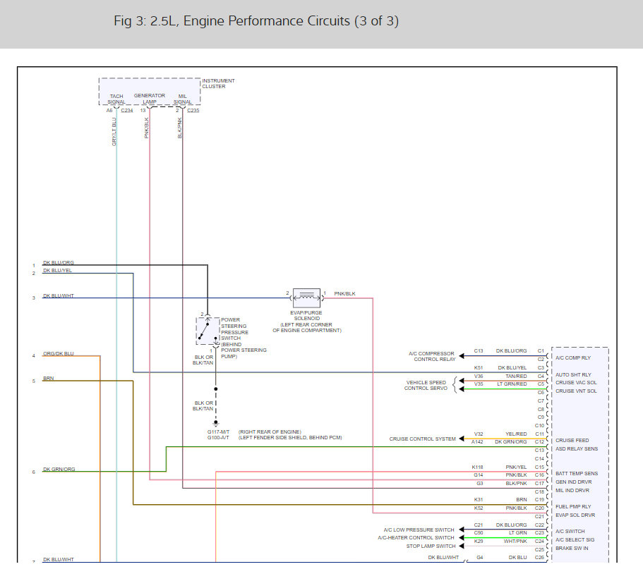

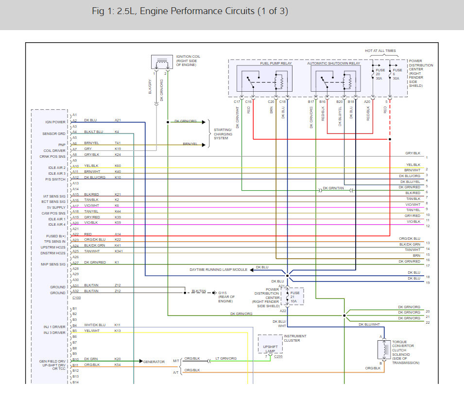

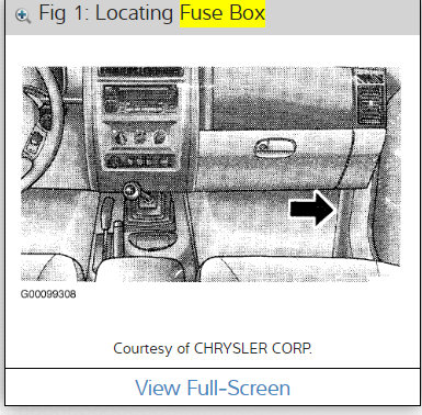

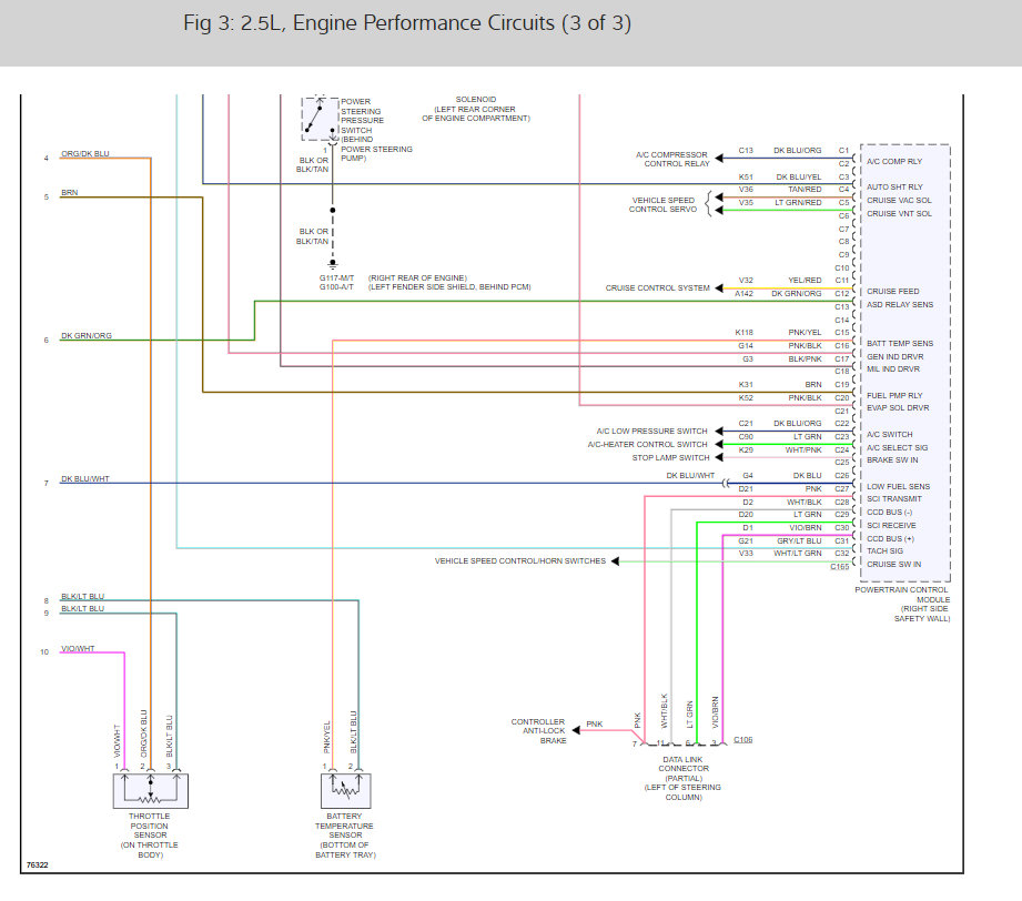

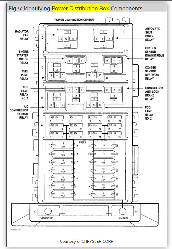

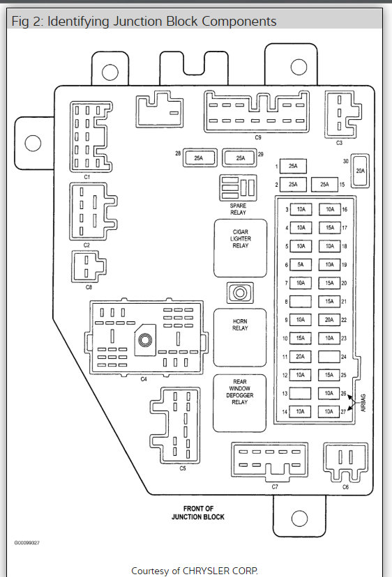

Let check the fuses first by using the guide and the fuse locations below. I also have the fuel pump wiring diagrams so you can see how the system works.
Check out the diagrams (Below). Please let us know what you find. We are interested to see what it is.

Hey Pros I have a serious problem. I got in my jeep yesterday it started fine, I drove it about five miles, went to get back in in to start it and it would not start. My fuel pump will not get output, i have no fire to the cylinders and my gauges don't work. Let me mention, it will crank and dash lights will work, but I have no fire to engine or fuel pump and gauges are out. I know it doesn't have a crash sensor, so do you guys know where I might have a problem? I have checked the ignition switch, crankshaft sensor and all fuses and relays. You guys helped me once hopefully you can again..... THANKS

Do you power to the fuel pump relay socket?

I do not, its like it's shut down somewhere between the harness and pump. I also have no fire going to the coil or plugs and my light on instrument panel work, but no gauges do. I have checked numerous things like the Balast resister, ignition switch, neutral safety switch, crankshaft sensor, and shift selector switch, fuses and relays too... any other suggestions what to check????

There is a module mounted on the fuel tank that the pump circuit passes through. If fuse # 16 in the underhood fuse block is good and you have power to the FP relay socket, the problem must be with the module.
The dash gauge system is feed with 2 circuits. 1- fuse #16 in the underhood block. 2- #9 in the block behind the right side kick panel.

I asked a question, about why my speedometer or my fuel pump would not work, well after days of searching for answers and listening to suggestions i found my problem. It was the crankshaft sensor was bad. I replaced numerous sensors and wiring harness and nothing fixed the problem, untill i changed that and my problem was solved.

Glad you found it. Many times on a Jeep, the CPS will fail and not trip a CE light. If the CPS was out, you should have lost injector pulse also. Problem is, there's really no good way to test them.

You can check the voltage for the fuel pump by removing the fuel pump relay from the control center under the hood. The control center also has a fuse for the pump itself. If the fuse is good, use a volt meter and check the terminals at the fuel pump relay. It should be 12v or very close. There is also a three wire connection near the fuel filter that has a disconect that you can check. Ground your voltmeter and probe the connection terminal closest the the engine. The middle wire should be hot when the key is in the run position.
