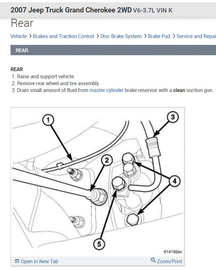

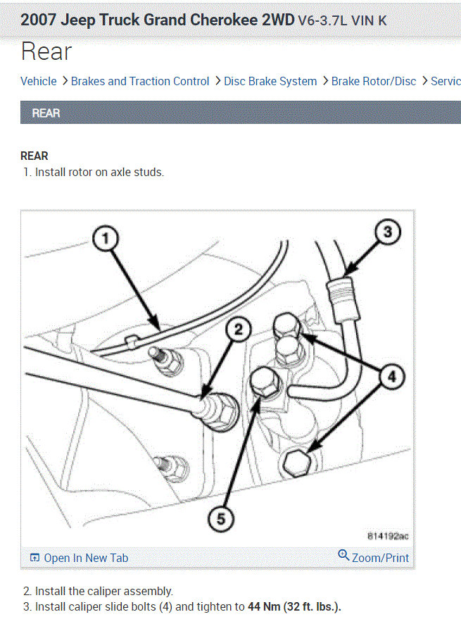

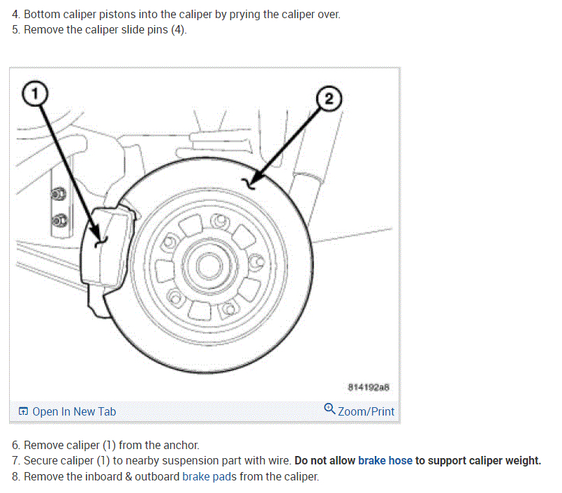

A brake light appears on the instrument panel that advises that my rear brakes are gone. Please help asap Thanks
Sunday, March 23rd, 2008 AT 2:16 PM
9 Replies
  • 109,867 POSTS
Replacing the rear brake pads and rotors isn't too hard to do. Just make sure to get a lifetime pad so you don't have to pay for them again in the future.
You can expect rear brake pads to last approximately 30,000 miles. However, that will change based on driving habits and terrain.
To get you started, here is a link that explains in general how it is done. You can use this as a guide.
https://www.2carpros.com/articles/how-to-replace-rear-brake-pads-and-rotors
Also, here is a video showing the procedure being done on a Dodge Nitro. Although it is a different model vehicle, the procedure is similar.
https://youtu.be/GwU7nfBaRr0

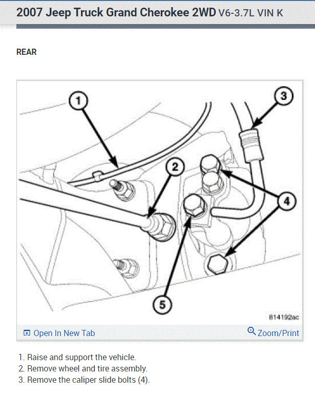

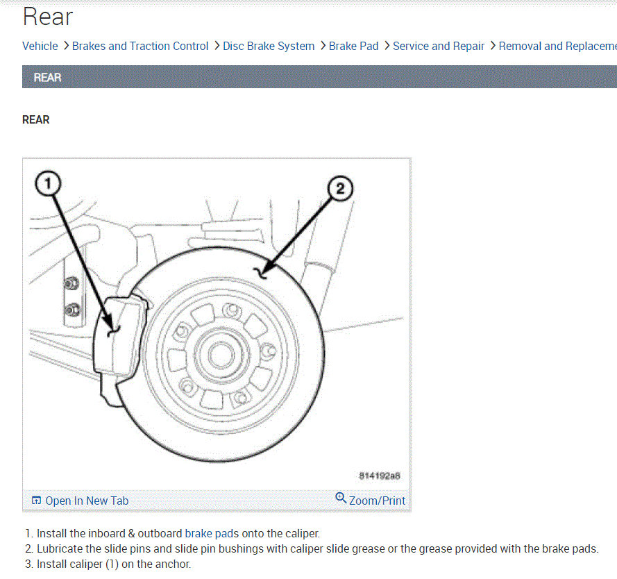

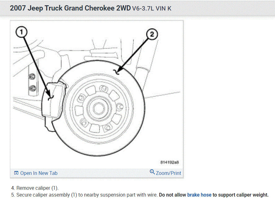

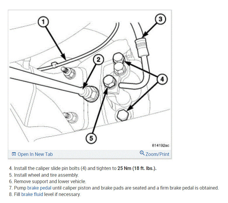

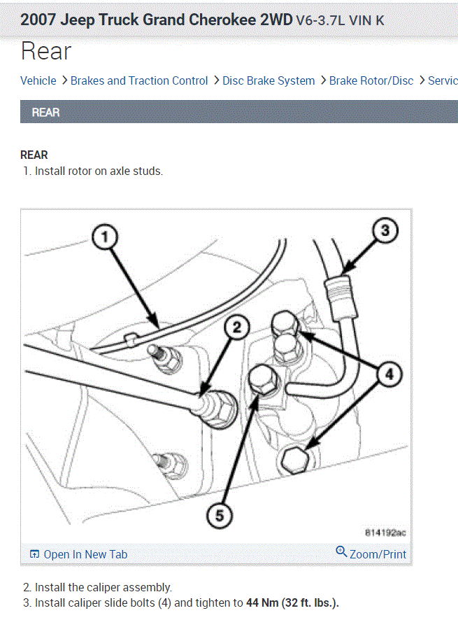

If you look at the attachments below, they provide the directions specific to your vehicle for rear brake pad and rotor replacement.

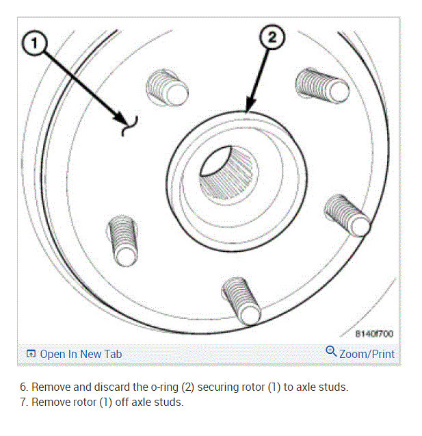

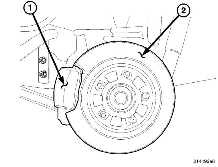

I posted below the procedure for the rotors. I also attached a guide for replacing the pads.
Please add a video of the noise so I can hear what you hear.

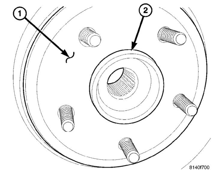

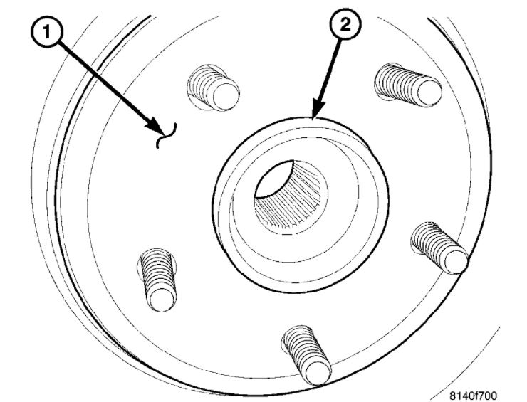

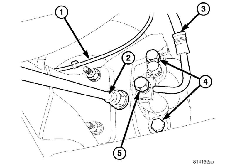

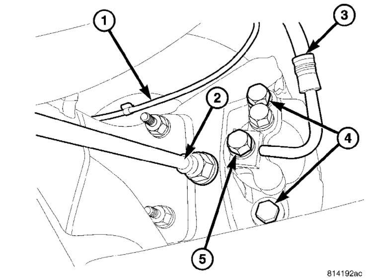

REAR ROTORS
REMOVAL
1. Raise and support the vehicle.
2. Remove wheel and tire assembly.
3. Remove the caliper slide bolts (4).
4. Remove caliper (1).
5. Secure caliper assembly (1) to nearby suspension part with wire. Do not allow brake hose to support caliper weight.
6. Remove and discard the O-ring (2) securing rotor (1) to axle studs.
7. Remove rotor (1) off axle studs.

Rear caliper bolts will not tighten all the way. There is about a 1/16 left showing on the bolt. I asked a friend who is a tool and die man if I cross threded the bolts he says no. They seem to long, could they have streched?
Thursday, May 20th, 2021 AT 10:09 AM (Merged)
  • 109,867 POSTS
The bolts are also the slides that the caliper moves on. They should only be threaded so far. If the thread is bottomed out, it should be fine. Also, if you can take a picture and upload it for me to see, I would feel more comfortable seeing it.
