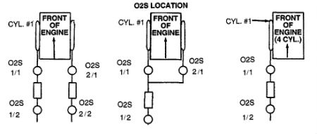

2005 Jeep Cherokee 6 cyl All Wheel Drive Automatic
OBD11 is lean on "bank 2" Which side is Bank 2?

See below
https://images.2carpros.com/forum/automotive_pictures/12900_o2_8.jpg
