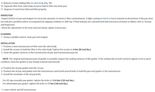

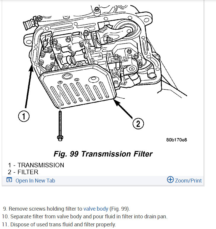

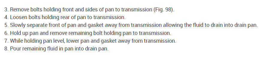

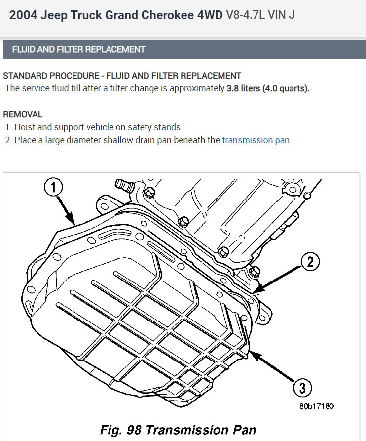

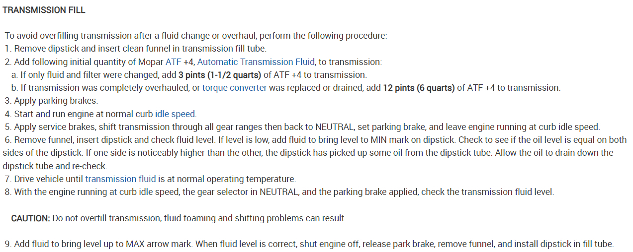

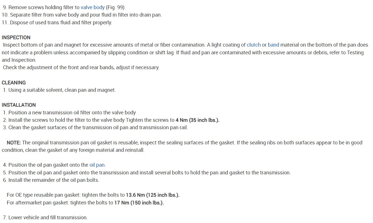

The transmission will whine when the fluid filter is clogged here is how to change it out to help fix the problem.
Mopar ATF +4, Automatic Transmission Fluid,
This guide can help walk you through the steps with instructions for your car are in the images below.
