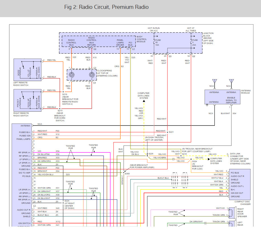

I recently had my car in for repair for the wipers. When I got my car back, the radio display light is no longer working. When I asked the mechanic, he told me that it was "just a coincidence" and "these things happen". As you can imagine, I was not happy about his answer but what could I do. They told me I would need to replace the entire stereo unit. Is this true??? The stereo/radio/CD player still work, but I can't see anything. I can't tell what radio station I'm on, can't see the time, can't see which disc or track I'm on, very frustrating.
Any help is greatly appreciated.
Thanks!
Dorothy
Mar 6, 2010 at 2:57 AM
CARADIODOC
  • 34,407 POSTS

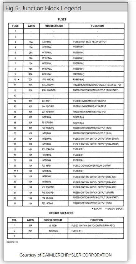

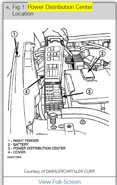

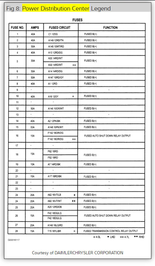

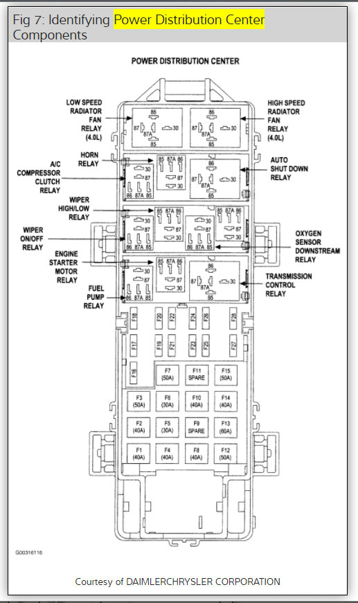

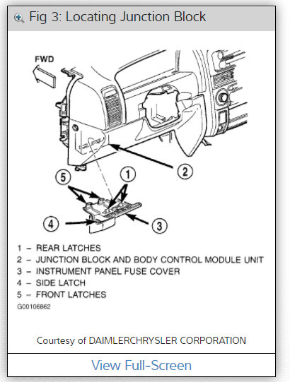

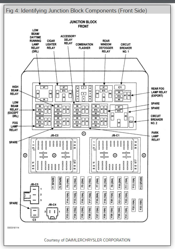

It sounds like the fuse #30 - 10 amp is out. Here is a guide to help you check it and the location of the fuse with the radio wiring diagrams so you can see how then system works.
Check out the diagrams (Below). Please let us know what you find.
