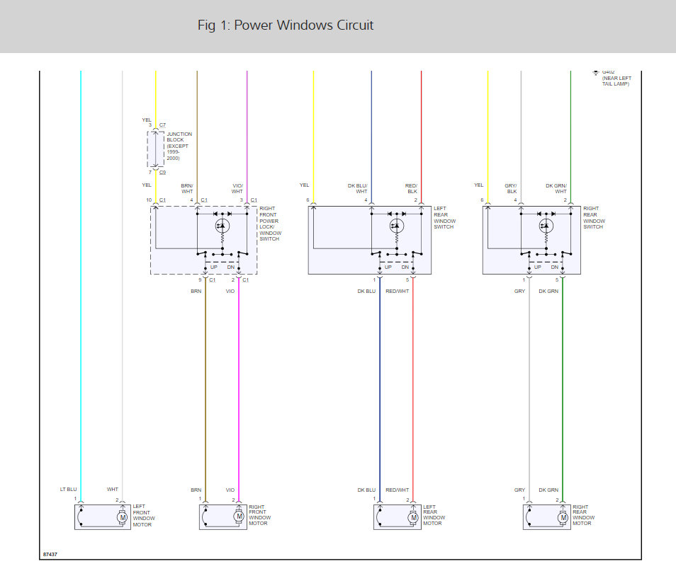

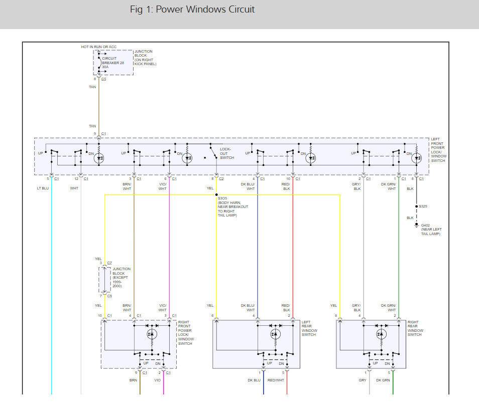

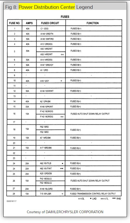

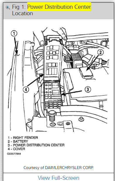

suddenly the power windows all of them and power mirrows went out at the same time--no fuse or circuit breaker??? vehicle is in exce3llent shpe well taken care of low miloage looks like it may be costly to repair at service center-is there another option or way to fix???
May 18, 2010 at 2:03 PM
  • 110,194 POSTS

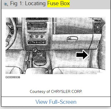

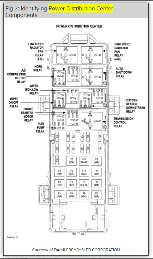

They are fused #12 - 50 amp fuse. Here is a guide to help check the fuses with diagrams for the fuse location below.
Jul 15, 2019 at 3:17 PM

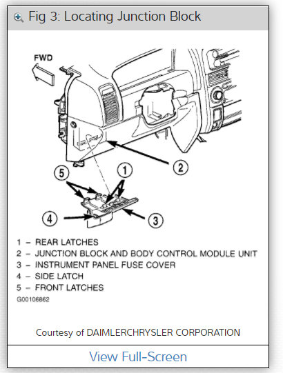

the power window buttons work on the drivers side but not the other doors is there a separate fuse for the other door and were is it located and do you know the fuse # or size.
Jun 23, 2020 at 2:28 PM (Merged)
  • 75,992 POSTS

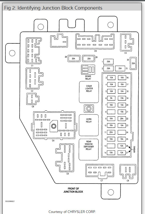

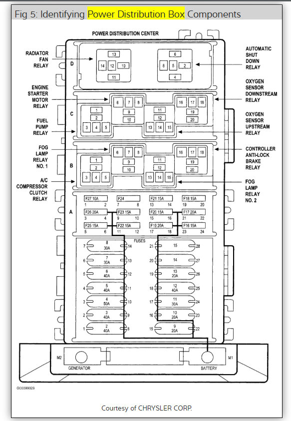

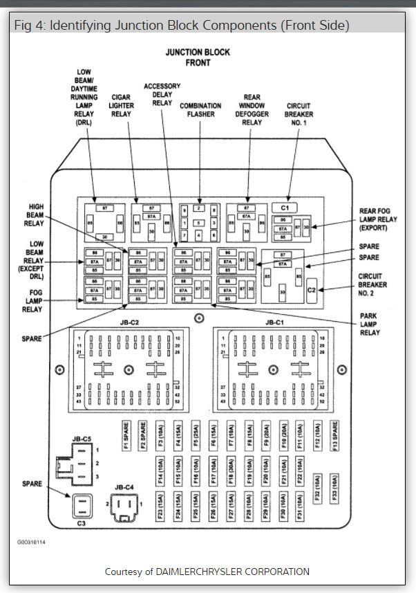

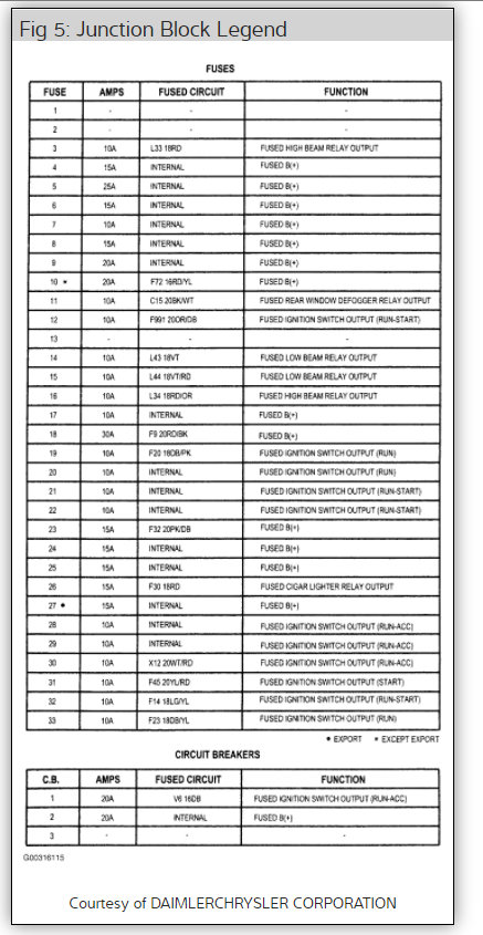

Here is a guide to help you check the fuses with the fuse identification and locations in the diagrams below with the window wiring diagrams so you can see how the system worsk.
