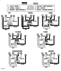

Hello, I have a jeep grand cherokee and one day all of a sudden I could not change the air flow to select vent, floor,or anything in between. the knob, no matter what posistion is always on defrost or off. The temp knob and fan level knob still work fine. I took the whole assembly out and I believe the problem is not in the knob. I also have checked all fuses. I suspect that there is a vacuum stuck somewhere. do you have any suggestions? I dont want to pay dealership prices to get this fixed. Thanks.

The mode control knob on the a/c heater control panel is used to direct the conditioned air to the selected system outlets. On manual temperature control systems, the mode control knob switches engine vacuum to control the mode doors, which are operated by vacuum actuators. On AZC systems, the mode control knob switches electrical current to control the mode doors, which are operated by electronic actuators need to check for codes vacuum supply line is connected at the engine intake manifold for the manual temperature control system.

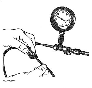

Manual with vacuum will not set any codes and have to check for vacuum leaks
black line under the dash should have vacuum all the time with engine running
check the diagram in the above post it shows how to check
