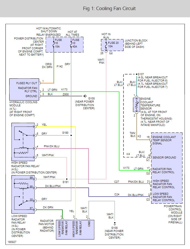

Notice the radiator fan relay control just above the low and high speed fan relays, my fan runs on high from engine start thus not allowing engine to come up to operating temperature. And my MIL is on indicating P01489 and P01490, both of which are talking of this PWM relay. I am sorry for the long question but I have a new control relay that was purchased using my 4.0L engine size.

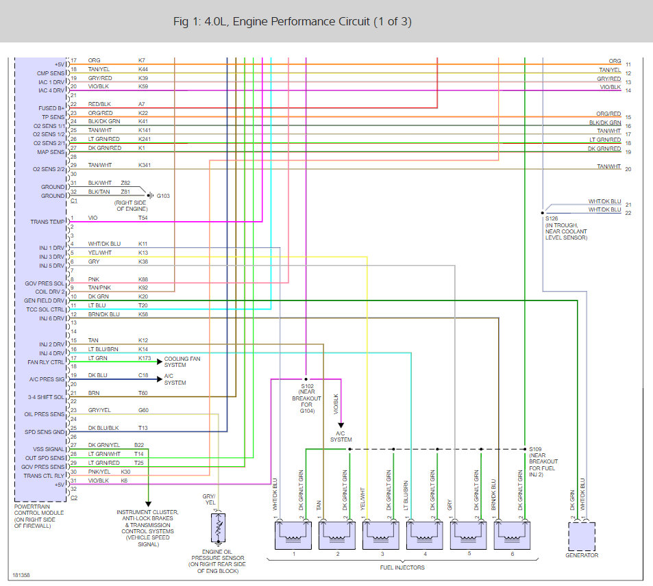

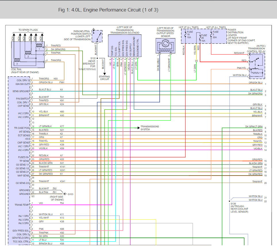

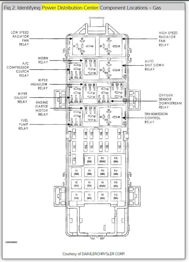

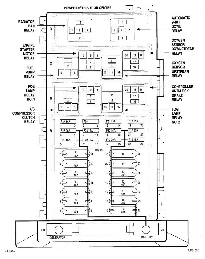

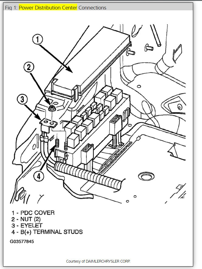

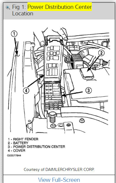

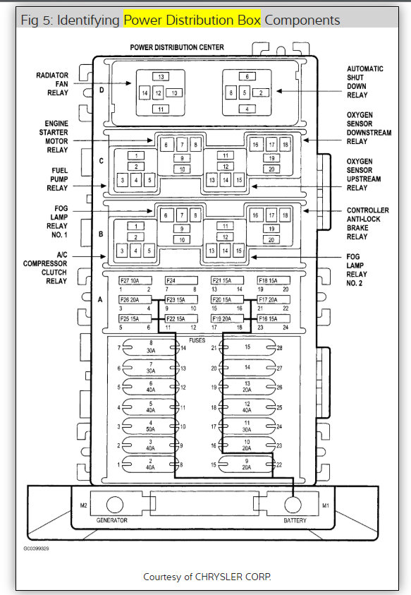

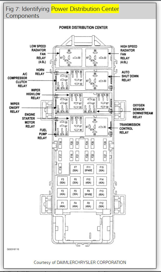

If its a 4.0L engine its located in the power distribution box-see below 2-fan speed relay involved.

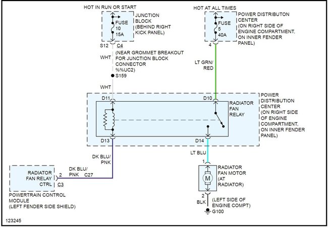

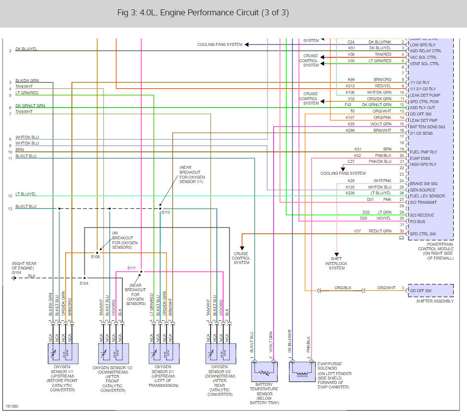

Here is the wiring diagram and relay location (below) along with some easy guides to help you with the testing.

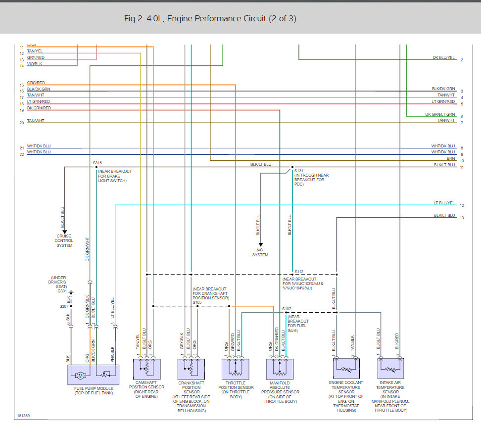

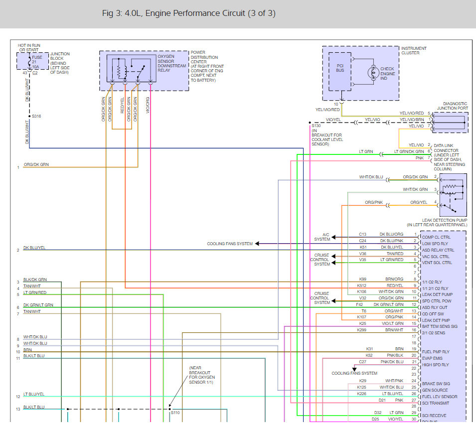

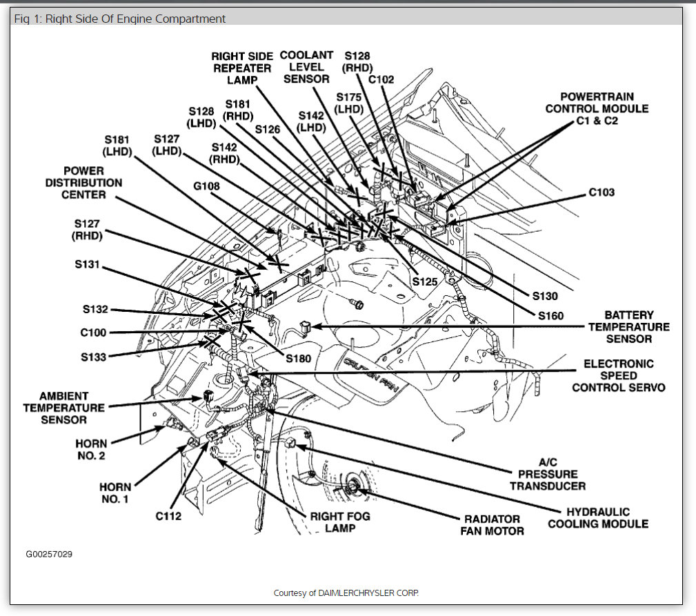

Here is the fan control module (below)
It will show up on the cooling fan EWD as I've provided.
P1489. High Speed Fan Control Relay
P1490. Low Speed Fan Relay Circuit
Above these 2 relays is a hydraulic cooling fan module it is not a relay and only applies to 4.7L engine.
The coolant temperature sensor feeds the computer the engine temperature. The computer decides whether only one fan is needed or 2 fans depending on engine temperature and AC load-Have your computer tested its jobs is to energize the appropriate relay as needed.

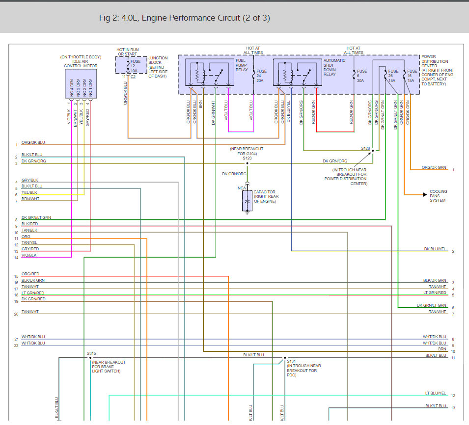

Here are the engine wiring diagrams if anyone needs them (below)

In the power distribution center next to the battery
See the guide below on testing relays, it will help

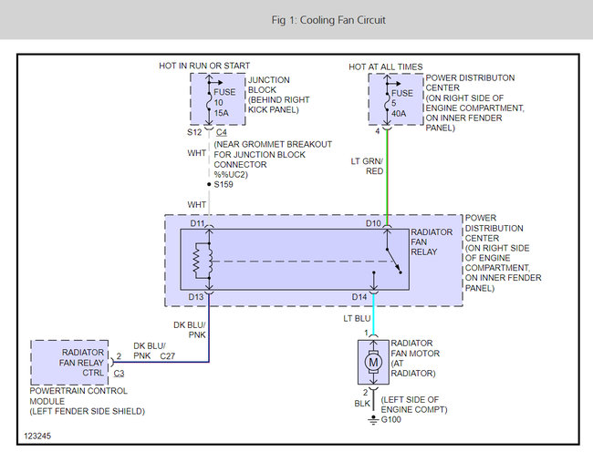

Attached below you will find the wiring diagram for the cooling fan as well as the relay location

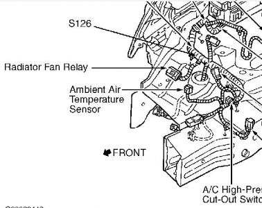

Under passenger side head light mounting panel. Both headlights must be removed along with the hood latch and mounting bracket to gain access to relay... Grand Cherokee

It's in the power distribution center, under the hood.

Hello, I take it since your mechanic cannot find the relay it is a Grand Cherokee not a Cherokee. The relay is located Behind Bumper Facia, Below Right Headlight...
https://images.2carpros.com/forum/automotive_pictures/188069_01grndcherokeeradfanrelay_1.jpg
The relay on a Cherokee is located in the Power Distribution Box under the hood

Here is the cooling fan wiring diagrams so you can see how the system works. There is no switch that runs it just the PCM and a relay with a fuse. Here is the relay location and a guide to test the relay and power.
and
Check out the diagrams (below). Please let us know what you find.

the fan relay in the 2001 cherokee is in the relay box which is located in the engine compartment on the pass side of the motor in a long black plastic box. On mine it is right next to my coolant overflow bottle. The relays for many parts are located there and the relays are labeled on the top of the box which comes off the bottom part. Many of the relays are interchangeable so you can remove the fan relay and try another 5 prong relay to see if that is your problem.

Sure have! there is a solid state relay behind the right headlight assembly,( a real @#%@% to change too!) There is an issue with these failing either not allowing the fan to work or turning the fan on continuously. Let us know!
