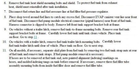

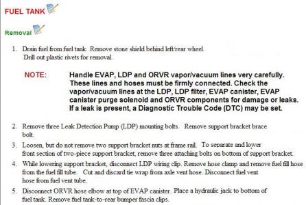

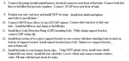

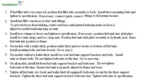

What do I have to do to remove the fuel tank in my 03 Grand Cherokee?
