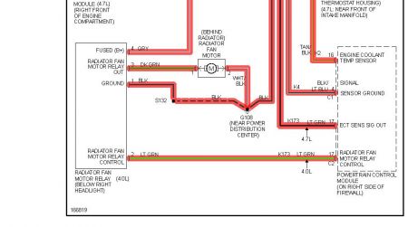

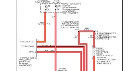

In the past three years I have replaced the fan motor relay three times and the fan motor once. After I have the relay replaced it takes about a year before I have the problem repeat
Nov 9, 2008 at 3:13 PM
  • 75,992 POSTS
Might be that one of these is causing the problem-Hydraulic cooilng module and the computer control of the relay
https://images.2carpros.com/forum/automotive_pictures/12900_cf1_11.jpg
https://images.2carpros.com/forum/automotive_pictures/12900_cf2_11.jpg
