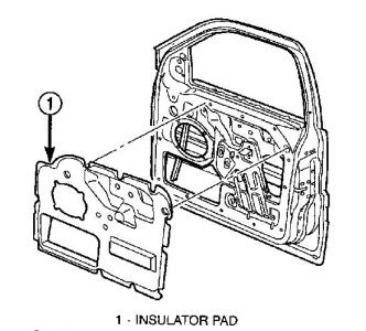

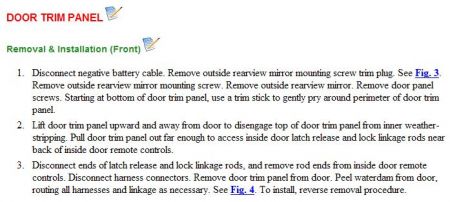

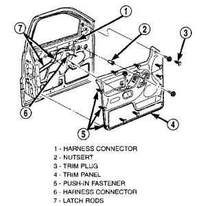

need to check the power windows that came off their frame- how do I remove the door panel?

Hello
Below is info. you requested.
FIGURE 3
FIGURE 4
