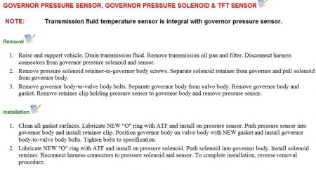

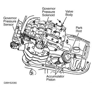

Hi.
I need to replace the governor pressure sensor in my 2002 Jeep Grand Cherokee Laredo, but I have no idea where it is or what tools I'll need. Of course, the Jeep dealership won't answer my questions.
Can you please help me?
