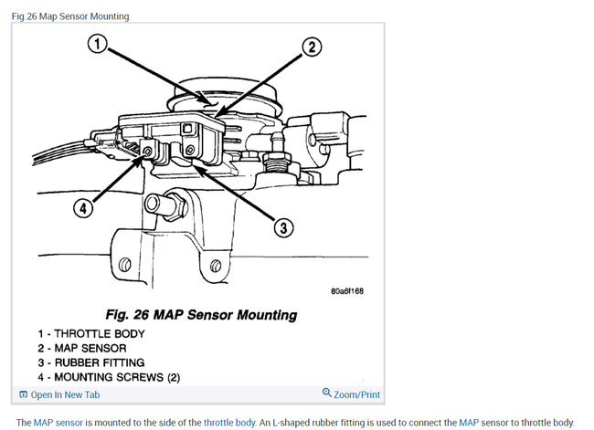

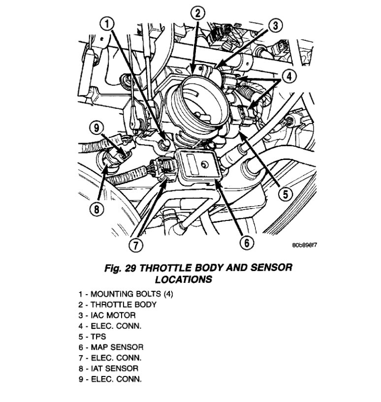

Hi.
where is the mass airflow sensor located or does it have a MAP sensor? Thanks!
Wednesday, August 5th, 2009 AT 7:56 AM
7 Replies
DOCFIXIT
  • 18,828 POSTS
If 4.0L in line 6 does not use MAF has a MAP. Check out the diagrams (Below). Please let us know if you need anything else to get the problem fixed.

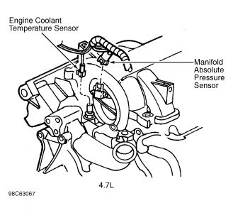

4.7 liter, I have taken the jeep to the dealership repeted time for the same problem, still unresolved. The jeep doesnt want to start, the strater seems fine, according to the dealership fuel system checks fine, the replaced the iac motor and the battery and I have replaced the starter and throttle position sensor. On your websites advice I subscribed to mitchell on demand, but, I cant find the location of the map sensor for the 4.7. Then again im not able to navigate very well. Could you please direct me on the eautorepair. Net to the diagram with the loaction of the map sensor for the 4.7 and give me some sound advice on the istarting issue.
Saturday, March 6th, 2021 AT 10:27 AM (Merged)
DOCFIXIT
  • 18,828 POSTS
Hi
MAP on intake see diagram
https://www.2carpros.com/forum/automotive_pictures/198357_Graphic_516.jpg
Has ECT sensor been checked out if faulty would make cold start difficult. Is vehicle hard to start all the time? Been doing this long time? any other performance problems?
Let me know
Thanks for donate
WOOWIZARD
How do I check the ECT? Can you tell me how you navigated to find the diagram? I appreciate your help.
Sincerly,
clueless
DOCFIXIT
  • 18,828 POSTS
Need OHM meter remove connector probe terminals engine cold should br 3K ohms as engine warms ohms drop if not replace. At menu for jeep click on Electrical, then click on Componet locations then click on sending units and sensors then MAP 4.7 click on Fig. 6 blue highlited
