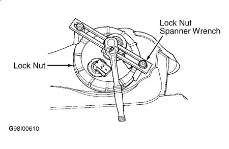

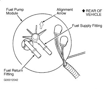

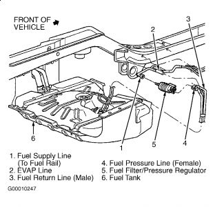

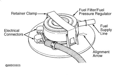

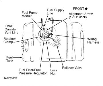

thank you for the reply. In more detail. Previously the fuel pump was replaced. Recently the engine light went on and the code referenced loose cap along with a number of other possible problems. I replaced the cap since the old one seemed to "click" with minimal torque. I mention the replacement of the fuel pump because most likely the tank is not leaking (its never been off road) do you think it may be the earlier repair or something else?
Thanks
Randy
Thursday, October 22nd, 2009 AT 8:37 PM
BMRFIXIT
  • 19,053 POSTS
I was going to ask if the tank was down before ,for a fuel pump replacement
most common to find that the seal on the pump leaking
