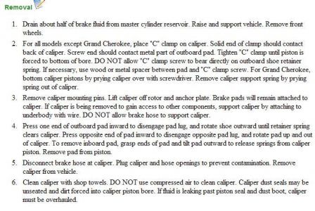

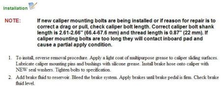

how do I replace the front brake pads on 2001 Jeep Cherokee sport. Can I use a C clamp to compress the caliber back.

https://images.2carpros.com/forum/automotive_pictures/261618_Noname_407.jpg
https://images.2carpros.com/forum/automotive_pictures/261618_Noname2_112.jpg
