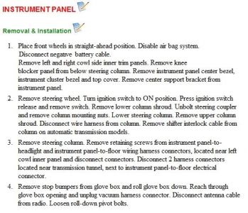

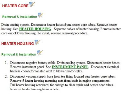

How difficult is it to replace the heater core in this vehicle.
