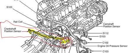

Engine quits and will not start for @ 15 minutes then starts and runs for short period. Replaced fuel module and filter, cleaned tank. Has happened 6 times in the past 3 days. Last time it died I checked the fuel rail and it had fuel pressure at the schreader valve. Seems to be heat related. I have seen this problem posted on a number of sites but have yet to see a solution.

Just had a similar issue it was crank position sensor that was bad Crankshaft Position Sensor (4.0L) located At left rear side of engine block, on transmission bellhousing wire connector is on the right side

I had same problem on my 1995 JGC I replaced that crankshaft sensor have patience, but same thing so I had computer replaced and that solved the problem good luck Declan.
