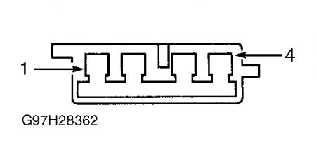

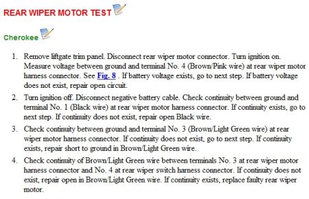

The rear wiper does not work, is there a relay of fuse to check before I take out the wiper motor?
