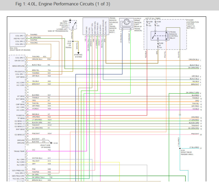

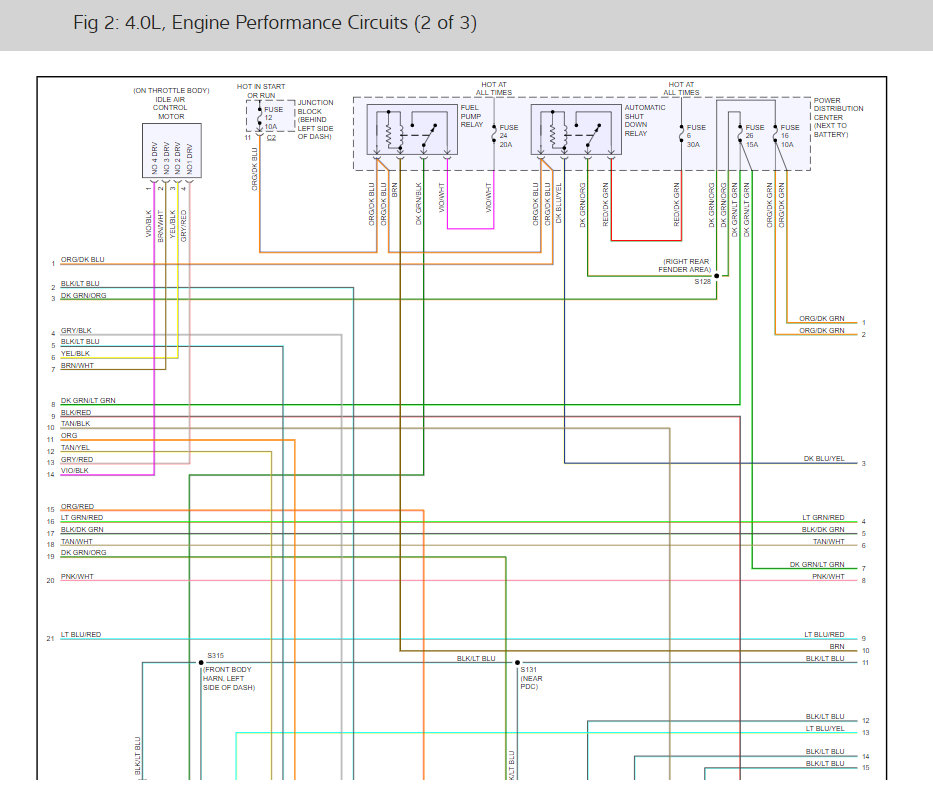

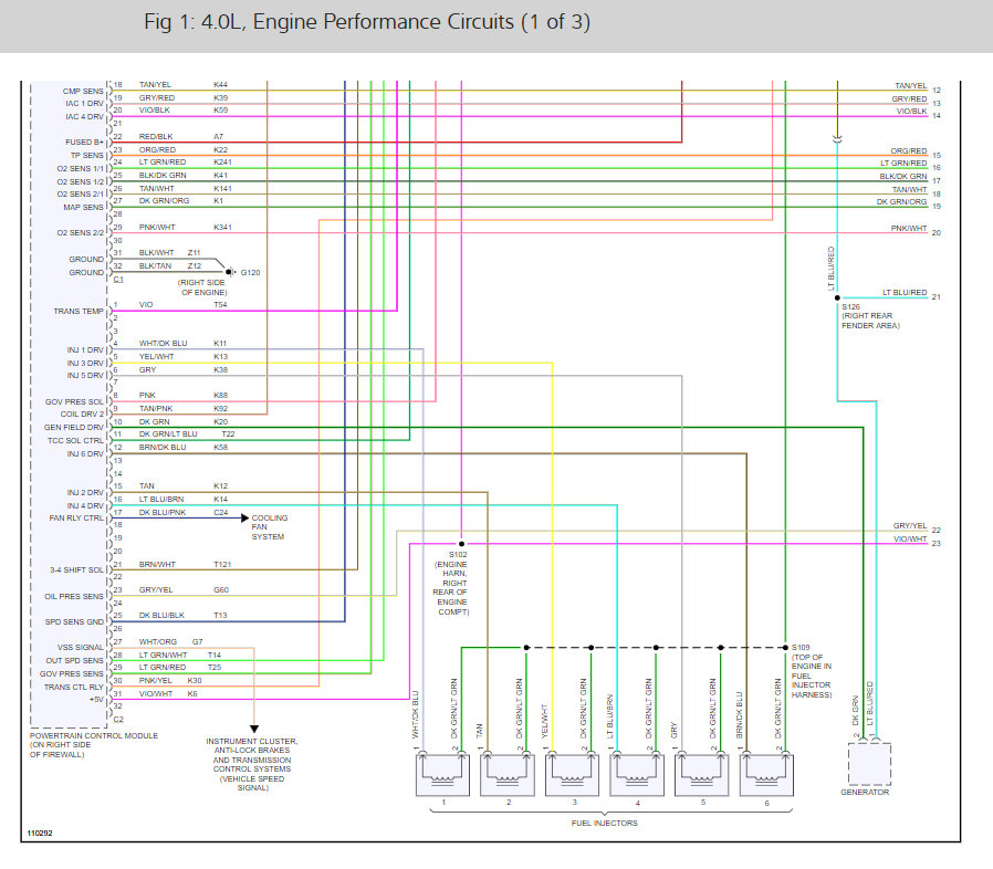

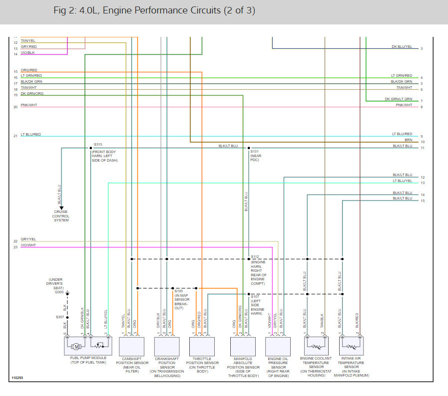

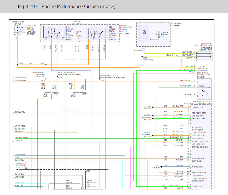

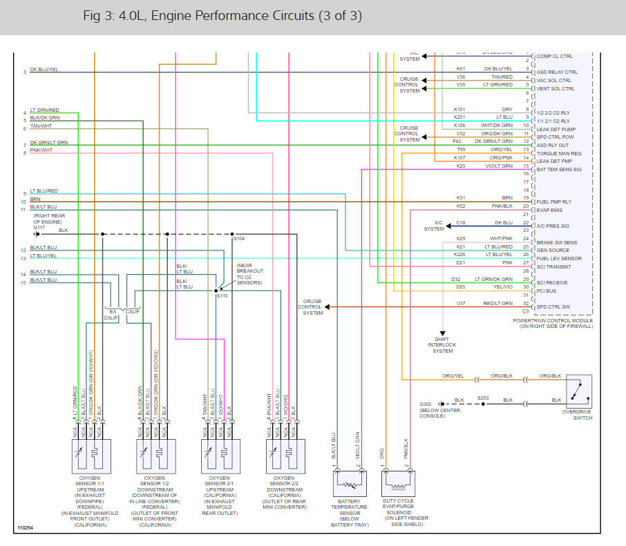

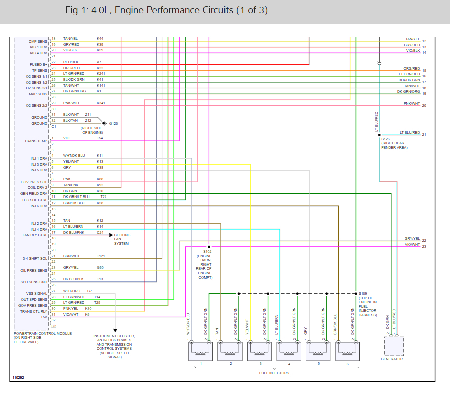

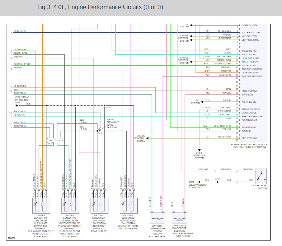

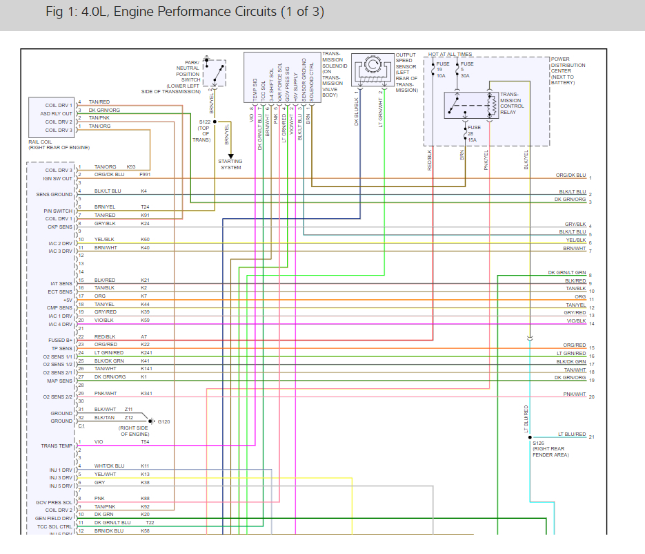

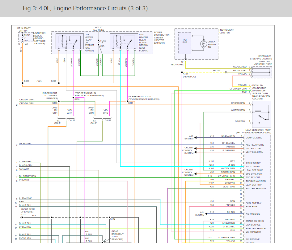

Here are the engine and oxygen sensor wiring diagrams so you can see how the system works. Check out the images (Below). Please let us know what happens.

Thank you for the try if you can send them in pdf I can blow them up so I can read them. However the fuse has blowen again and only two codes appeared p0141 and p0161 so maybe the part is on the way out and we will soon have a place to go please keep your finger crossed. I only have .1 points so I guess I can not leave feed back I am sorry this is my first time using the site i would give you a hundred. Well I got to go to bed only 10 more weeks before I can go home to my family and hopefully stay for a time Uncle Sam can be hard to work for some times.

Hi Jack
The prints are great I can not thank you enough for this. I could not find the fuse in that Haynes book but it looks to me as if a relay is having an issue looking at the prints F17 and that would mean that I have been looking at the wrong part. I even had a mechanic pull them out and test them to make sure I was doing it right. He said they tested good to bad we did not know about the fuse then because Alan is a good egg and has helped my family a lot.
This makes some kind of sense because the vehicle sat for almost two years while I was in Iraq, Resistance up Current up fuse gone, will let you know if this is a fix. the hole time I was under the impression that the fuse was a direct connect to the heaters on the O2 sensors.
