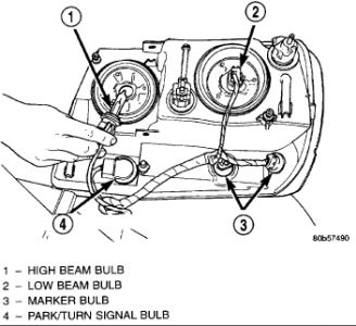

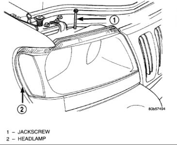

How do you replace the lowbeam headlight (drivers side)?

Remove jack screw attaching top of headlamp to headlamp mounting module.
https://images.2carpros.com/forum/automotive_pictures/248015_2_35.gif
Grasp upper inboard and lower outboard corners of headlamp and forcefully pull headlamp outward. Remove all bulb sockets from headlamp module. Separate headlamp from vehicle. INSTALLATION CAUTION: Do not touch the bulb glass with fingers or other oily surfaces. Reduced bulb life will result. Install all bulb sockets in headlamp module. Position headlamp on vehicle and align ball studs with sockets. Forcefully push headlamp inward to secure ball studs with sockets. Install jack screw attaching top of headlamp to headlamp mounting module. REMOVAL Remove headlamp. Turn bulb socket one quarter turn counter clockwise.
https://images.2carpros.com/forum/automotive_pictures/248015_3_25.jpg
Remove socket from lamp. Pull bulb from socket. INSTALLATION CAUTION: Do not touch the bulb glass with fingers or other oily surfaces. Reduced bulb life will result. Position bulb into socket and push into place. Position bulb socket in headlamp and turn bulb socket one quarter turn clockwise. Install headlamp.
