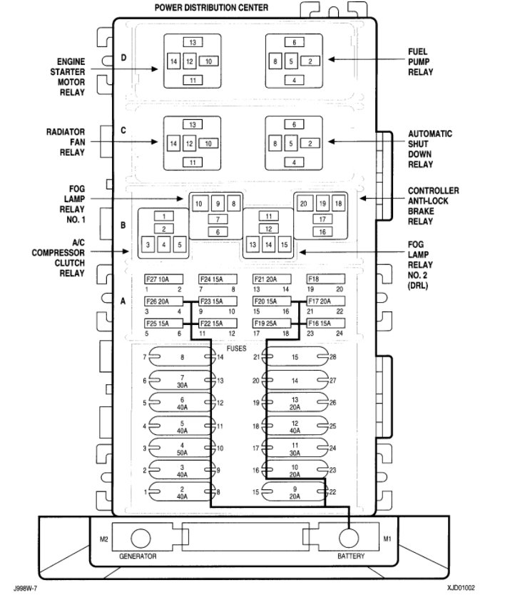

I am working on this 1999 Jeep and it will not start. I have checked all fuses, relays, grounds, and battery voltage all are ok. I have replaced the engine computer with a used one and I am still having the same problem. But, I am not sure if the used one was any good. Where is the ASD relay or fuel pump relays? James

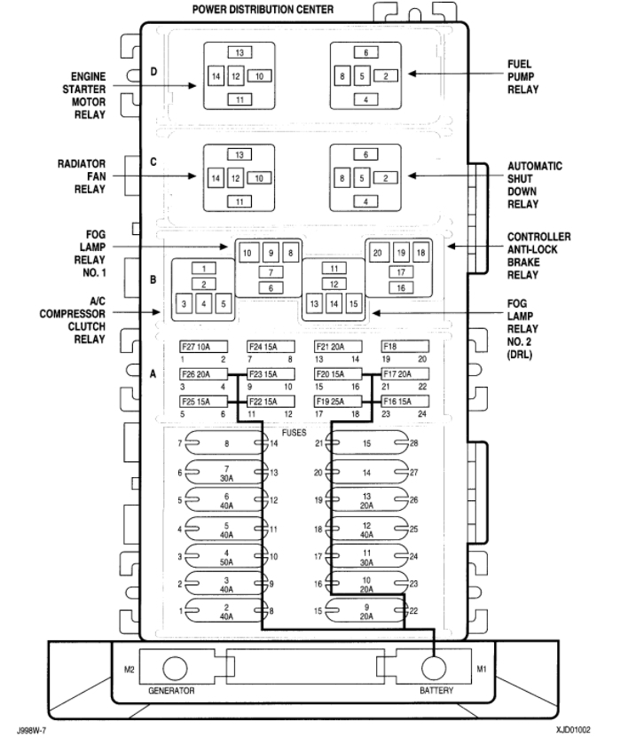

Here is a guide to help you check the relays with the ASD and fuel pump relay location in the diagrams below.
Check out the diagrams (Below). Please let us know what you find. We are interested to see what it is.

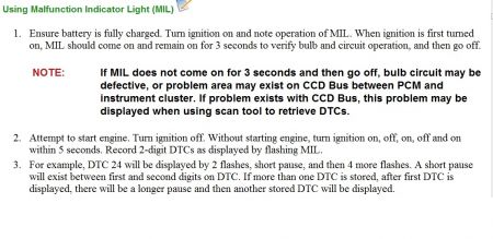

The asd relay or circuits could be a possibility? Have you tried checking for possible mil codes? The dark green wire with orange tracer is primary voltage to the coil. That wire should be hot with engine cranking. Try this to check for mil codes. When cycling the key, you don't crank it, just turn till dash lites come on.
https://images.2carpros.com/forum/automotive_pictures/512072_cherokee_mil_1.jpg

ASD relay is in the power distribution center, right fender side shield. learn how to check relays at
https://www.2carpros.com/how_to/how_do_i_check_a_relay.htm
