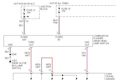

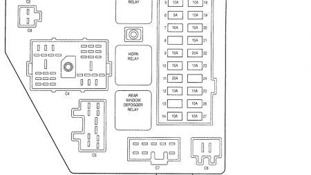

1999 Jeep Cherokee turn signals
156,253 MILES • 6 CYL • AWD • AUTOMATIC
CHISLAMIC42
The turn signals are out and I already replaced the turn signal switch but I have no idea what fuse to change out or where they go because I have no diagram for it.
Jun 11, 2010 at 6:04 AM
INTERNETMECHANIC
  • 700 POSTS
Does the hazzard flasher lites work? Fuse 12--10 amp should be the turn fuse, interior fuse box.
https://images.2carpros.com/forum/automotive_pictures/512072_cherokee_fuse_box_1.jpg
https://images.2carpros.com/forum/automotive_pictures/512072_cherokee_turn_signal_1.jpg
Jun 11, 2010 at 6:58 AM
