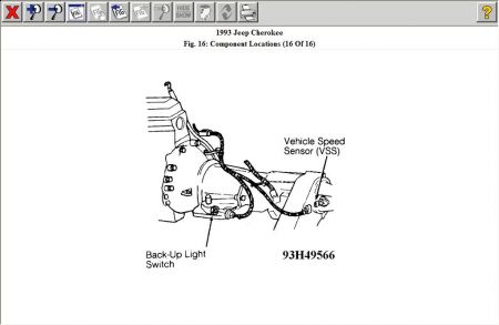

MADDOX
SPEEDOMETER DOESNT WORK, IT IS READING 180MPH IN A SITTING OR DRIVING POSITION, IS THE SPEED SENSOR BAD OR POSSIBLY THE PINION GEAR BAD?
Jul 13, 2020 at 3:54 AM (Merged)
  • 75,992 POSTS
Inspect and test the vehicle speed sensor its at the transmission extension housing
https://images.2carpros.com/forum/automotive_pictures/12900_vss_22.jpg

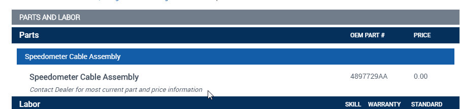

My speedometer cable bounces so i took it out and lubed it with graphite with no luck the bouncing is still there. I've tried to re lube it with several different lubes with no luck. I don't understand what is the problem?

GREENCHEVYMALIBU
  • 230 POSTS
thanks i'll change it and get back to you with the outcome. which cable should i replace. There is a real short one that connects to the cluster then to what looks like a sensor then from the other end the long cable bolts to it and to the transmission.

do you know where i can get both. AutoZone sells universal cables but i don't think they have the little cable.

Just to add. I attached the OEM part number for the cable. You can cross reference this most anywhere and get an aftermarket one as the OEM is no longer available (at least as a new part).
