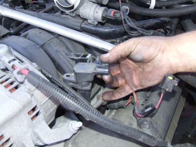

whear are the spark plugs? are thay cuvered by metel?

If it has the coil on plug system(COP) they each have thier own coil, and you remove the screw holding the coil remove the electrical plug to it, and pull it out...plug is in the hole!
