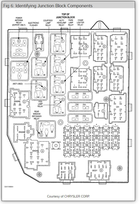

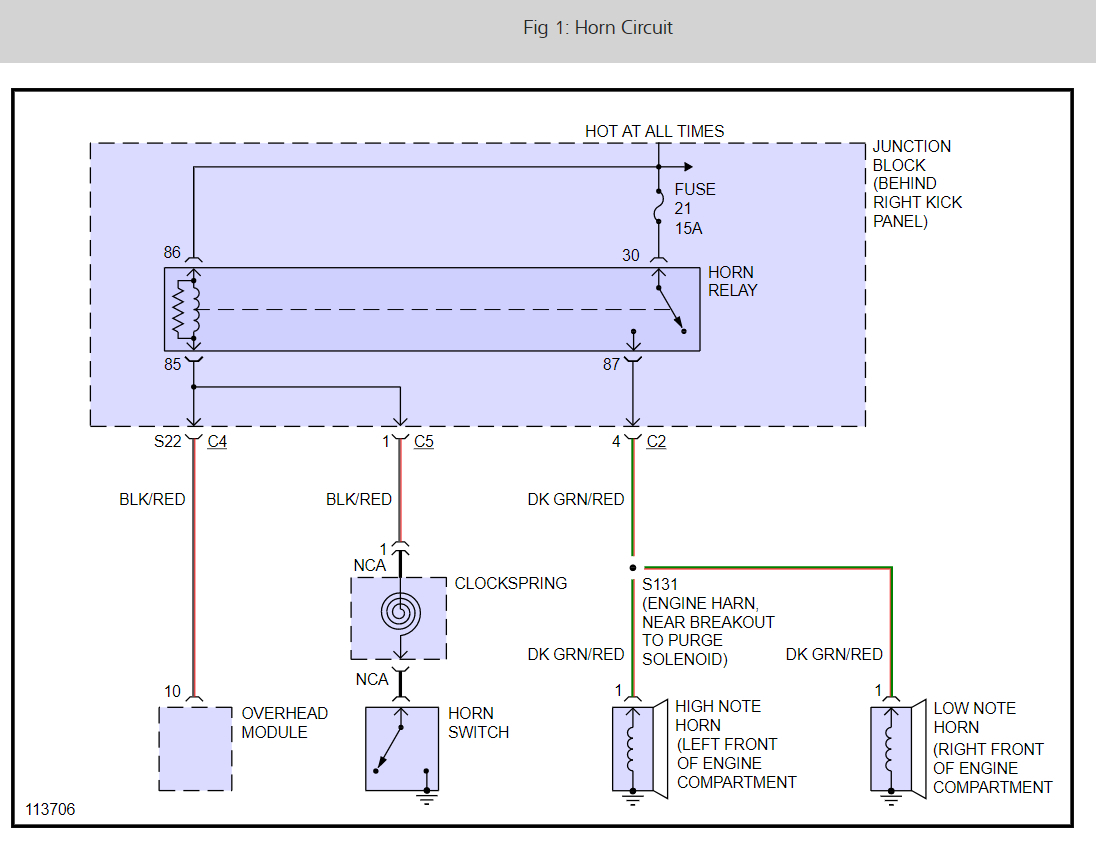

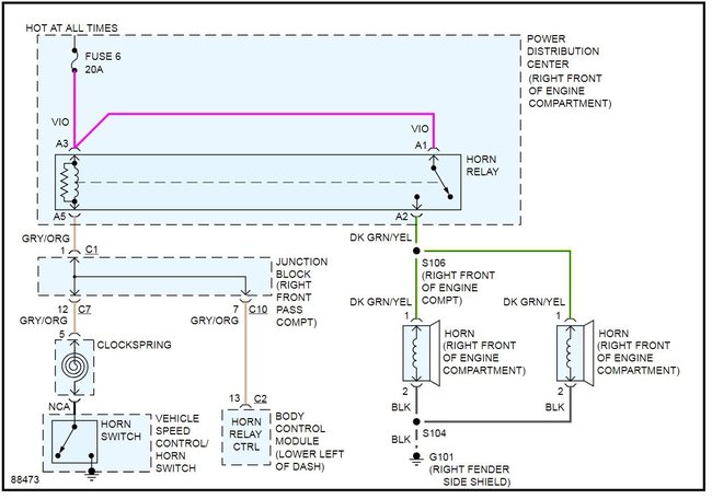

There is a horn relay that sounds like it is not working. Here is a a horn system wiring diagrams so you can see how the system works. This guide will help you test the relay when you find it from the diagrams below.

The problem is usually in the steering column. You could use a voltage tester at the horn relay. Terminals 30 and 86 are hot all the time. Terminal 85 is ground for the coil side of relay, your horn switch, grounds the circuit. When the relay is grounded, that arm with the arrow-head moves to terminal 87, 87 carries voltage to the horn.

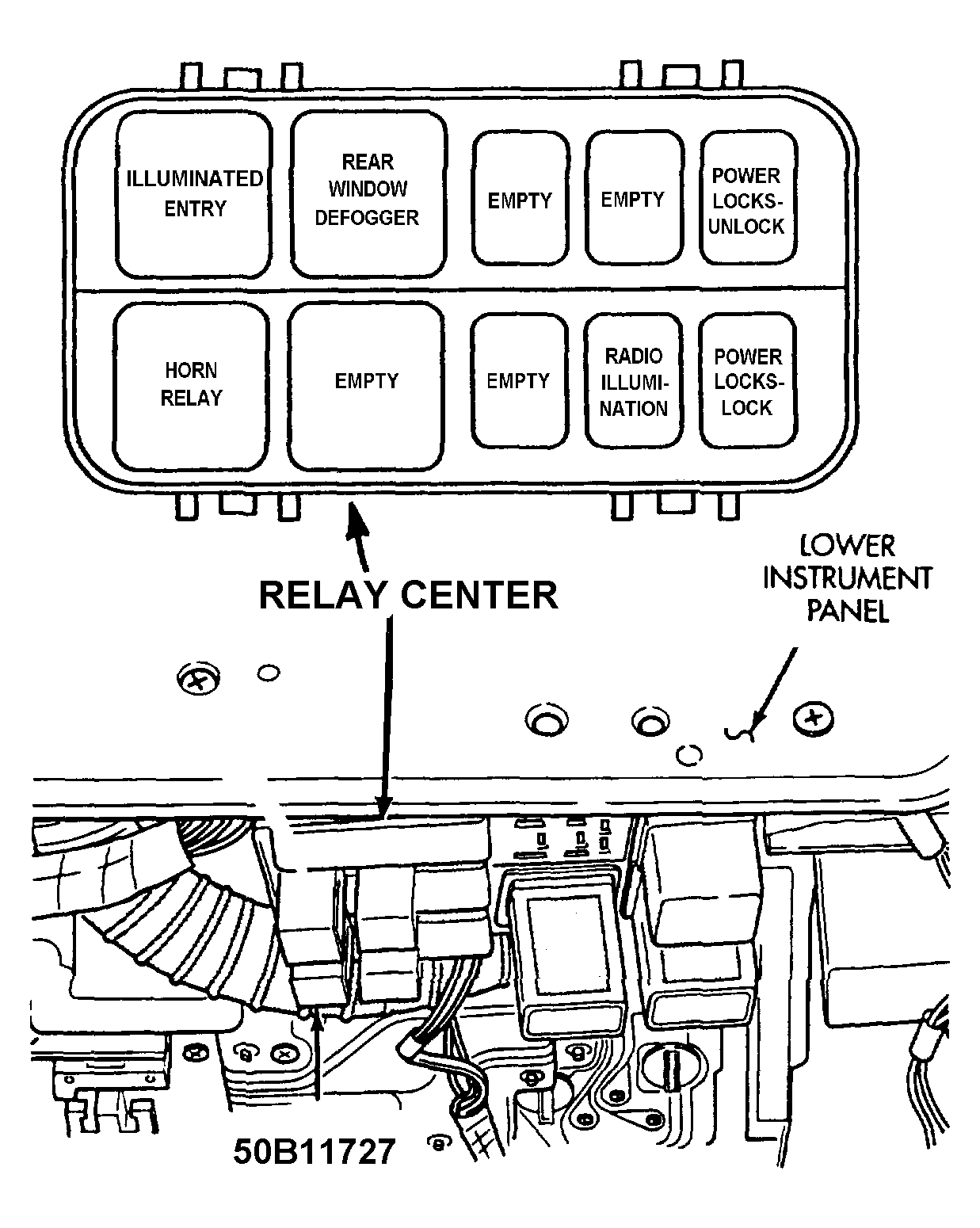

The horn relay should be located in the junction block under right side of dash. I don't know what else to tell you?

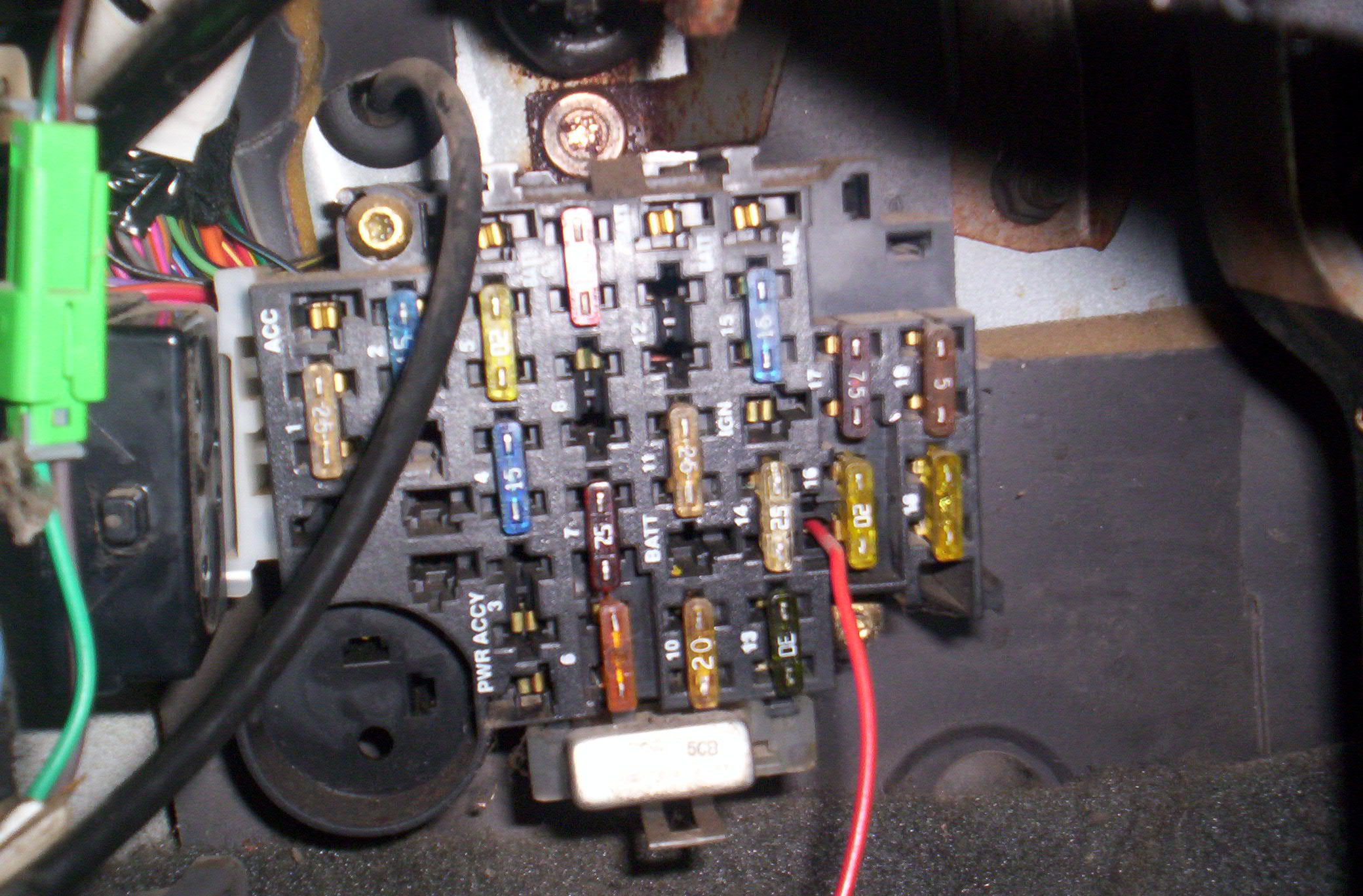

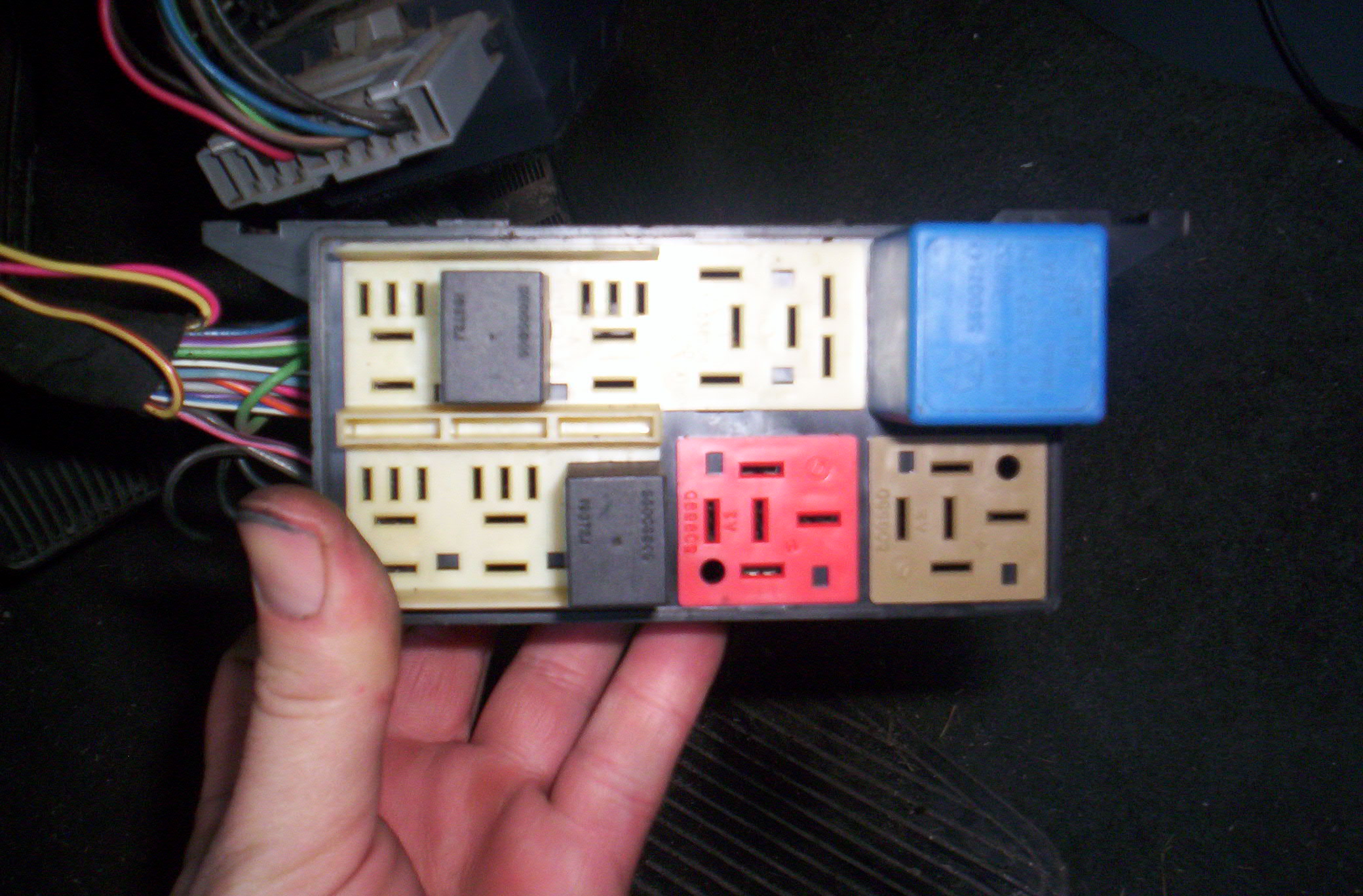

STONE CLONE

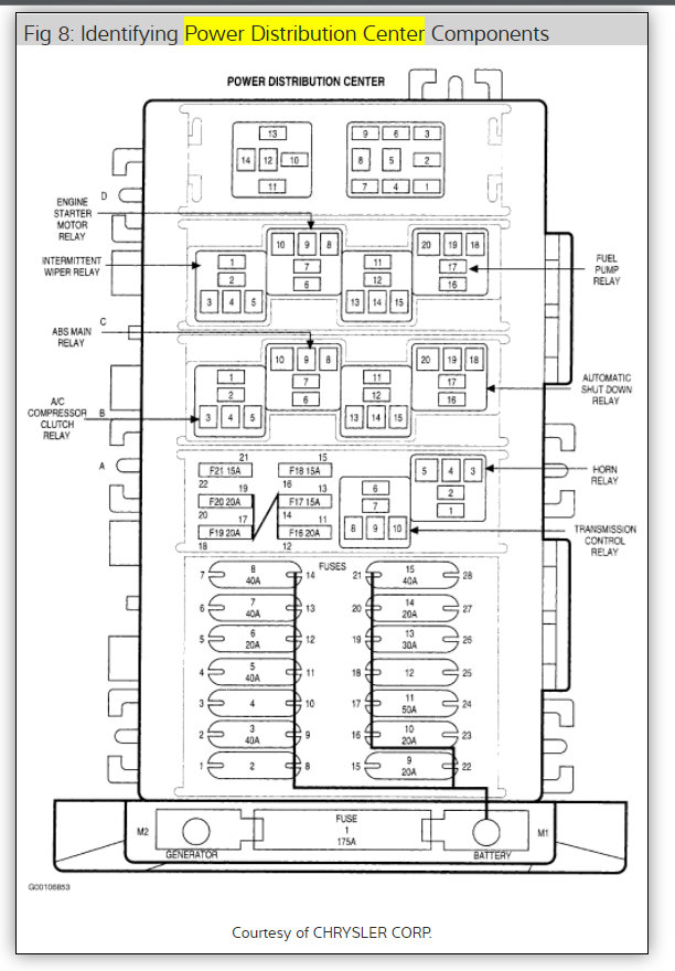

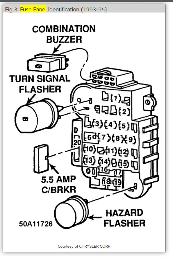

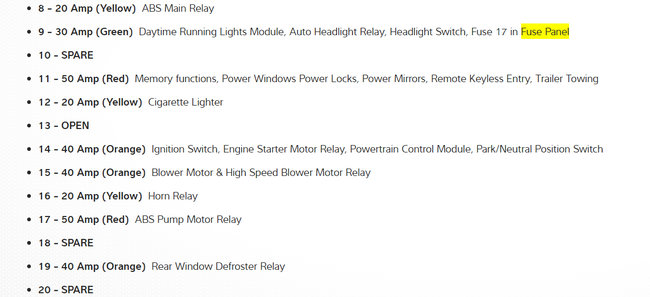

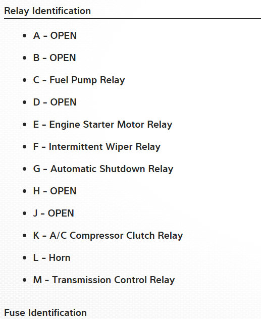

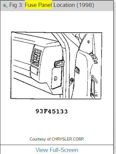

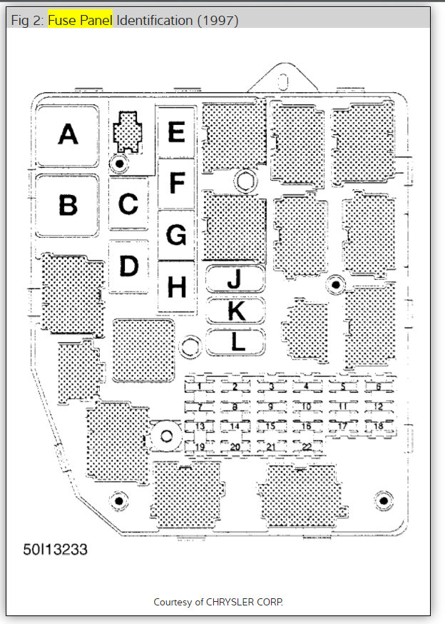

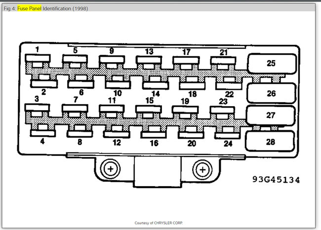

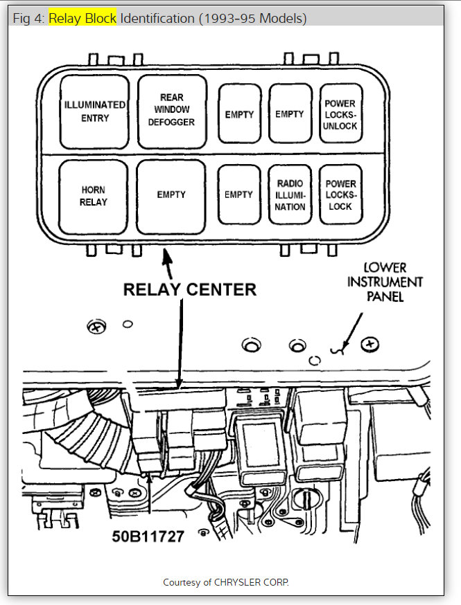

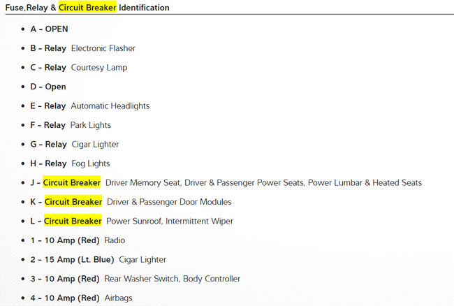

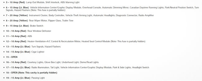

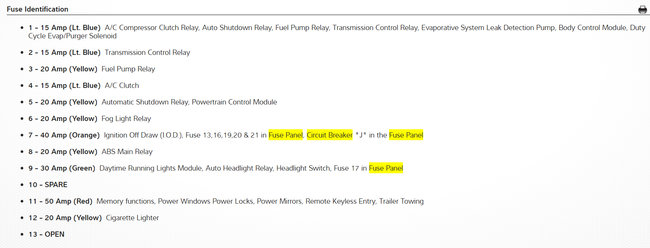

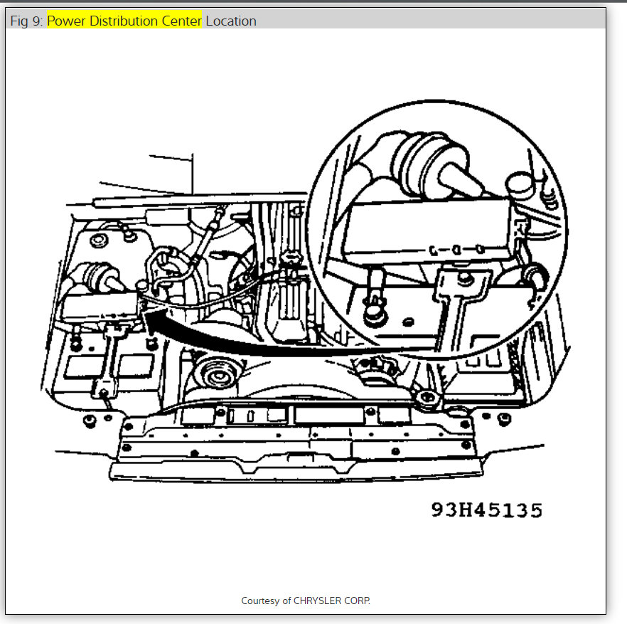

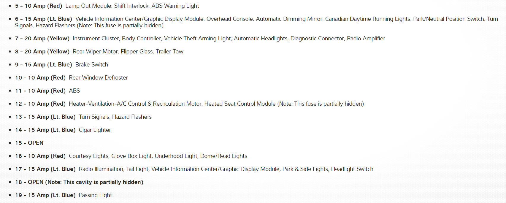

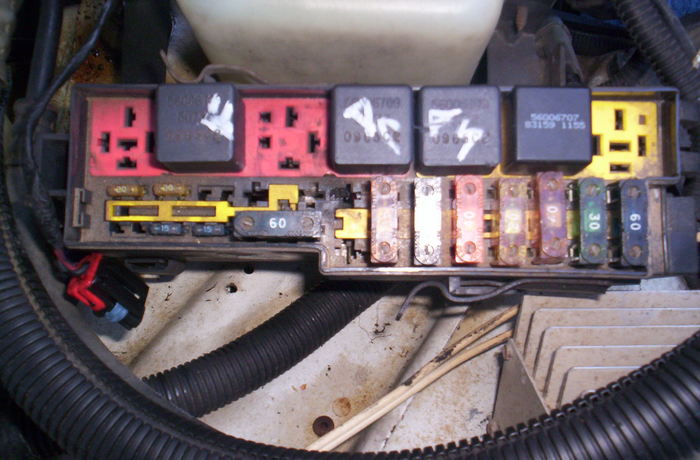

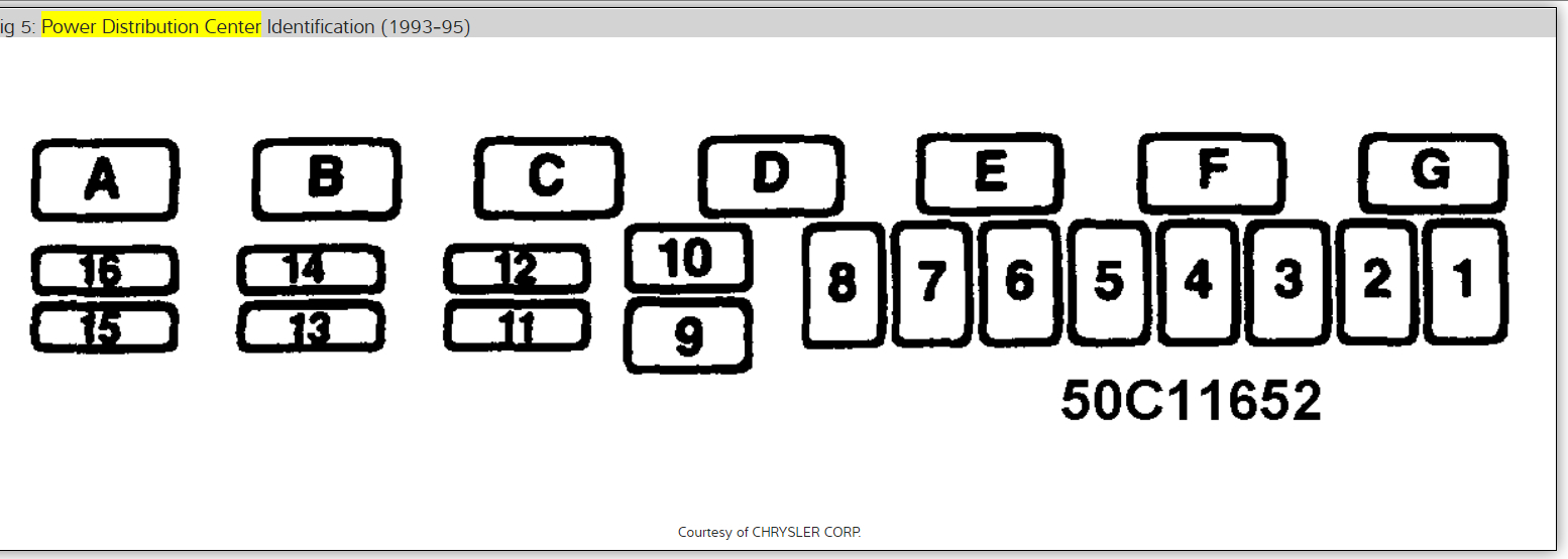

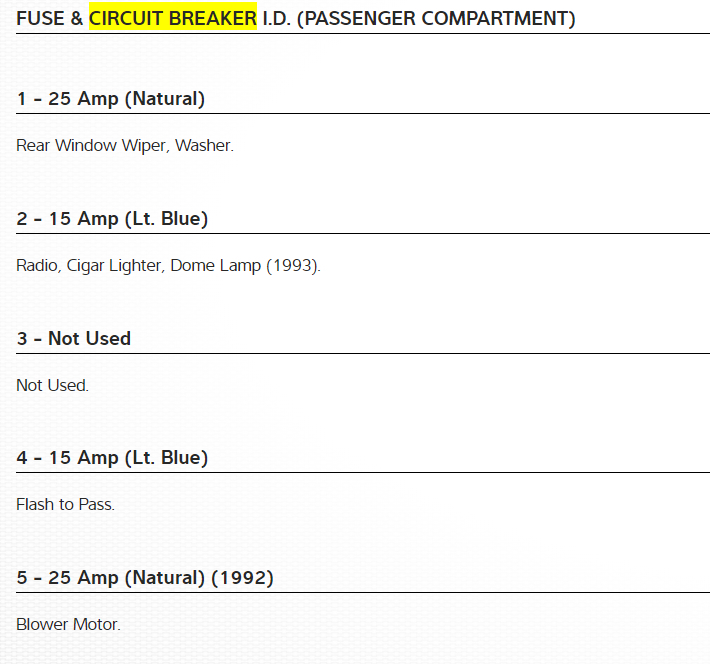

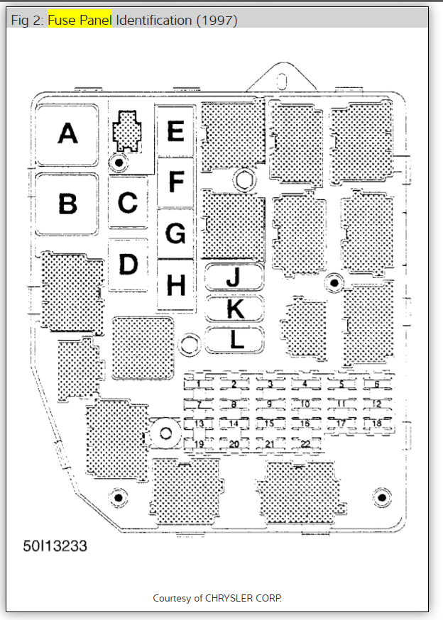

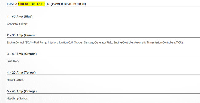

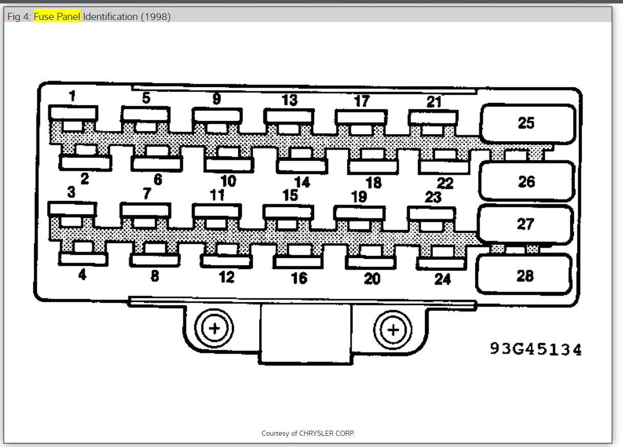

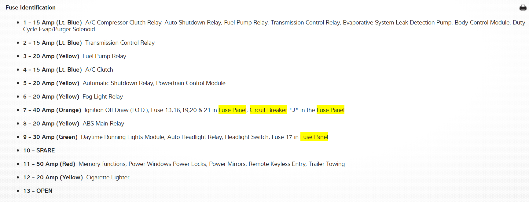

Where is the horn relay located on a 1995 Jeep Cherokee? Are there any pictures to show where it can be found?
Nov 11, 2019 at 10:01 AM (Merged)
  • 75,992 POSTS

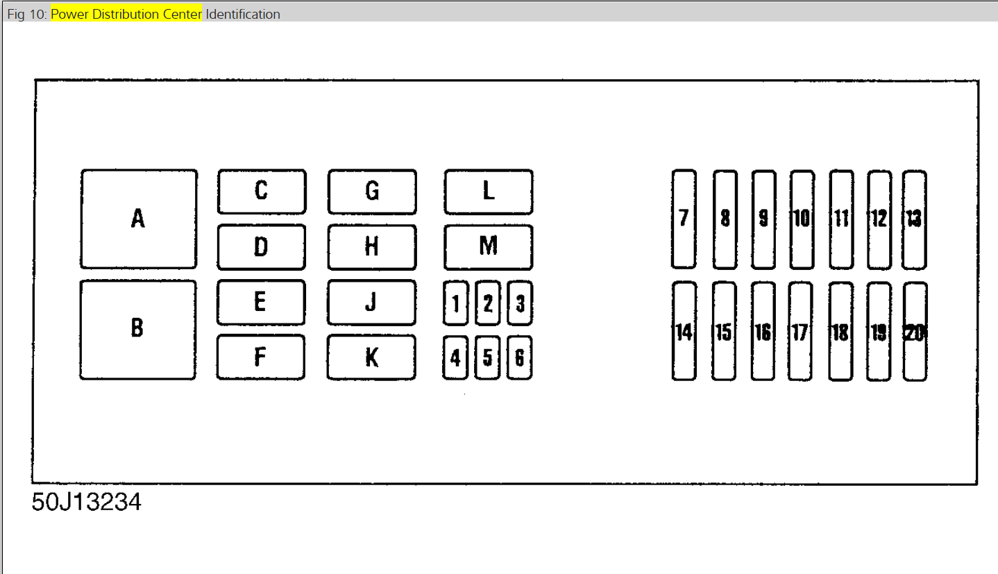

The horn relay is located in the fuse panel. Here is a guide to help test it with the location in the diagrams below.
STONE CLONE
Is this under the dash or under the hood? I have nothing that looks like this that I can see. Thanks for your help. I really appreciate it.

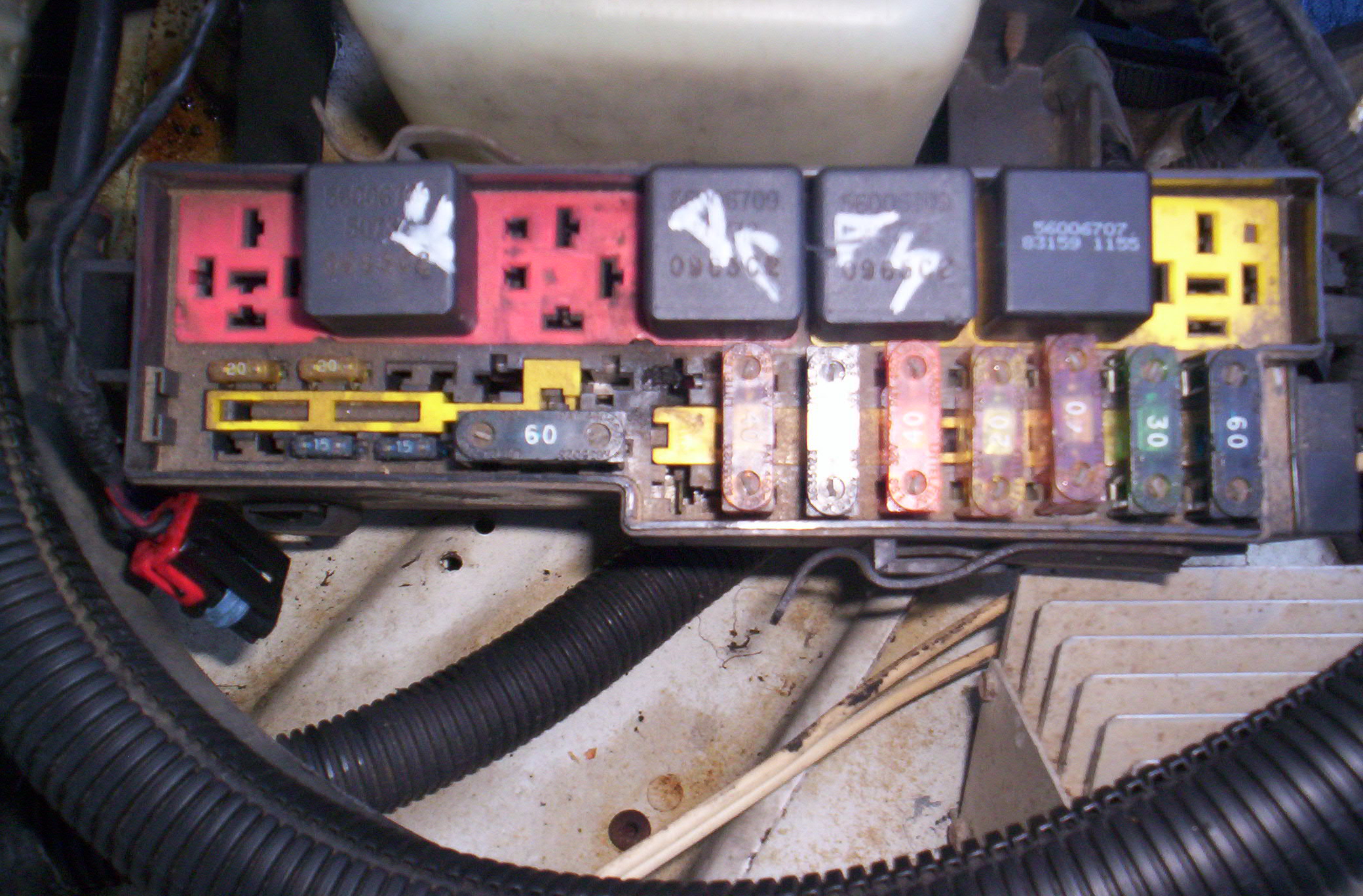

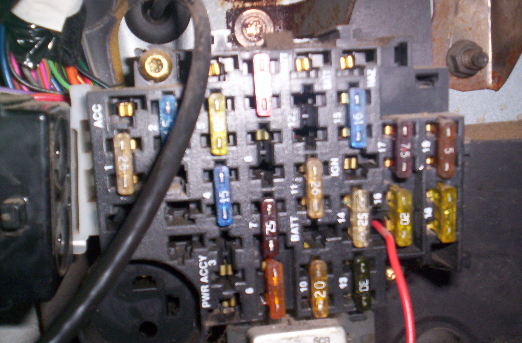

STONE CLONE

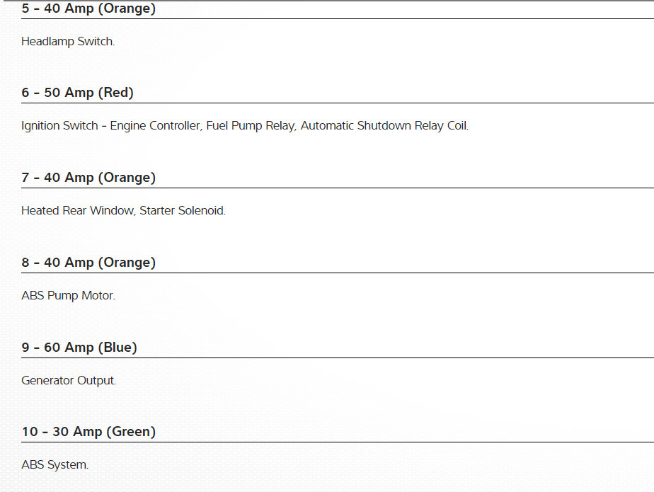

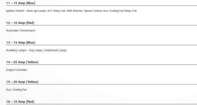

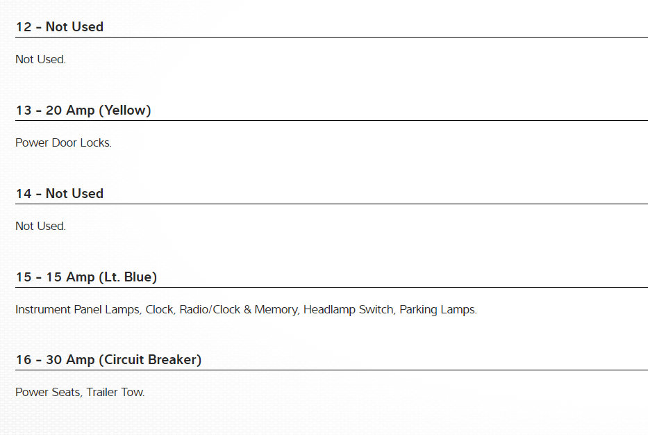

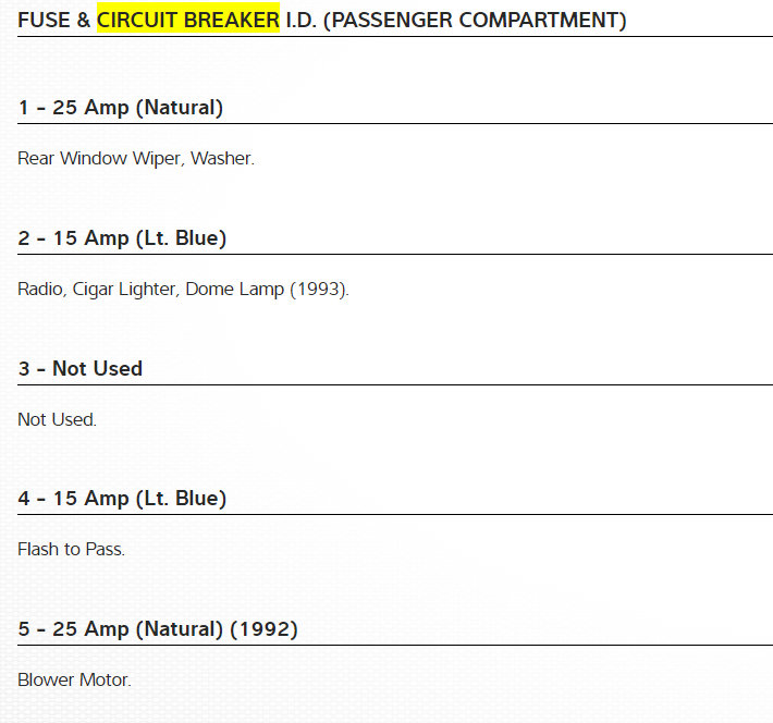

I am going to post a few pictures of what I've been looking at. Maybe that will help us out.
  • 55,097 POSTS
I found this. Check out the diagrams (Below). Please let us know if you need anything else to get the problem fixed.
Nov 11, 2019 at 10:02 AM (Merged)

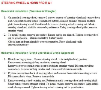

Hi, i cant seem to get my horn to work. its seems as though the actually horn button wont go down, as if it was stuck. is there a way for me to remove it to fix the problem if it can be fixed?
BLACKOP555
  • 10,386 POSTS
take off the steering wheel cover and touch the two horn wires together NOT AIRBAG WIRES, if the horn works, then the switch is bad adn should be replaced, if not and the switch is functioning properly, check the relay and the horn itself.

DRJACK
Electrical problem
1993 Jeep Cherokee V8 170,00 miles
The horn does not work. It will blow if you set off the alarm system, but not from the steering whell buttons. Fuse is good and I also replaced the relay, since jumping across 30 and 87 on the relay socket made the horn work. New relay, good fuse, good horn, but still missing something here. Any ideas?

most likely horn switch on steering wheel since all other components were already tested OK

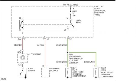

[quote:88a2f95045="bluelightnin6"]most likely horn switch on steering wheel since all other components were already tested OK[/quote:88a2f95045]
I got schematic of the horn sysem and narrowed it down to that switch. Can't figure out how to get to the switch though.

the clicking behind the glove compartment area you are hearing would be that of the horn relay. relays click when they open and close, if it's clicking when you are not wanting it to (when you're engaging horn button) then it means the relay is bad and needs replaced.

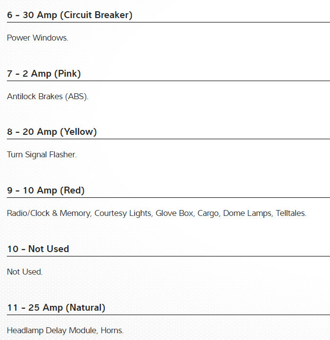

I was curious to see if you guys know how to fix my horn? I have a 1998 Jeep Grand Cherokee and it's just doesn't make any noise at all. Thanks!
Nov 11, 2019 at 10:03 AM (Merged)
BLACKOP555
  • 10,386 POSTS
first thing to check is the relay and see if its clicking when horn button is pushed. if not check the horn button and the relay. if its clicking and no horn response check the wiring and the horn.
Heres a guide on testing wiring
Attached below is the wiring diagram for your horn
