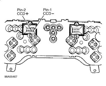

We had some issues with the pins and wiring failure dealer should have a patch harness hit to repair if its the issue that you have
have to remove cluster and check the connectors pins
very common is pin 1& 2 on cluster check for corrosion ,oxidation will look like black or maybe gray in color
I think they had a tech bulletin on it I will try and look it up
