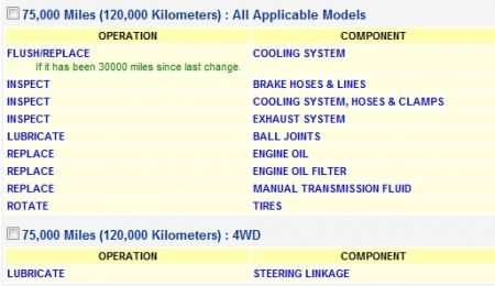

Winter is over and the car just went over 70k, what is needed to be done for a tuneup for the summer
thanks

https://images.2carpros.com/forum/automotive_pictures/261618_Noname_2076.jpg
