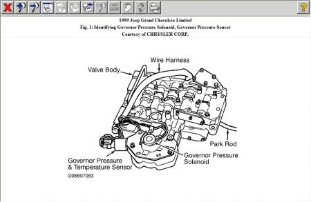

Do you know if the pressure sensor and the solenoid are two seperate pieces because I seen on some jeeps the governor pressure solenoid is all one piece.I only made a small donation because I gambled on your site and im not a big gambler if the payoff was big I would pay more
+1
Sunday, March 21st, 2010 AT 1:58 PM
  • 75,992 POSTS
https://www.2carpros.com/forum/automotive_pictures/12900_gp_1.jpg
Sunday, March 21st, 2010 AT 2:24 PM
  • 75,992 POSTS
GOVERNOR PRESSURE SENSOR
NOTE:Governor pressure sensor may also be referred to as governor pressure transducer.
Governor pressure sensor delivers an output signal to the PCM indicating the output pressure of governor pressure solenoid. The PCM uses this signal to control governor pressure. Governor pressure solenoid is located on valve body.
GOVERNOR PRESSURE SOLENOID
Governor pressure solenoid generates governor pressure required for transmission upshifts and downshifts. Governor pressure solenoid is located on valve body. Inlet side of governor pressure solenoid is exposed to normal transmission line pressure and outlet side provides a passage to governor circuit in the valve body. Governor pressure solenoid regulates transmission line pressure to the governor circuit. Electrical supply voltage is supplied to governor pressure solenoid by PCM. The PCM controls the ground circuit to governor pressure solenoid to provide solenoid operation.
