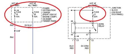

I have had this jeep for 3 years and recently I had to replace a dead battery.The problem is that a factory theft alarm now thinks I am stealing my car and will not let me start it.I am using 2 regular (non electronic) keys that I got when I bought it. How do I disable or bypass this damn thing?I had to cut the wires to the alarm horn to shut it up but twisted them back together.
Apr 14, 2009 at 9:27 AM
ZACKMAN
  • 4,202 POSTS
You can't disable or bypass the alarm. It is a part of Chrysler Collision Detection and controlled by the Body Control Module. If you have black key, you don't have chip-coded key, gray key is coded, however.
https://images.2carpros.com/forum/automotive_pictures/55316_98cherokeealarm_1.jpg
Remove these fuses (16 and 26 on the PDC, and 21 on the junction block). Wait a minimum of 2 minutes, and then put them back. Open all doors, including hood and trunk. Close hood, trunk and all doors. Make sure that the driver door is the last one to close. From the outside and using the key, lock the driver door. Wait a minimum of 1 minute. From the outside and using the key, open the driver door. That should reset the system. If it doesnt work the first time, try again as it can be finicky if not done exactly right
