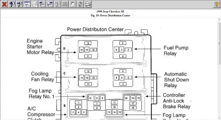

no power to fuel pump after being hit from behind
updated 12/23/09
where is the fuel pump relay located

If there's no power at dark green and white wire at the fuel pump connector-check and test the fuse no.21 15amp and fuel pump relay-if both okay could be a problem with the fuel pump control relay circuit of the computer.
Dec 19, 2009 at 8:01 PM
  • CAR REPAIR CONTRIBUTOR
  • 75,992 POSTS
The fuel pump relay is in the power distribution center.
https://images.2carpros.com/forum/automotive_pictures/12900_fp_relay_15.jpg
