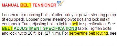

need to know how to replace the serpentine belt on a 98 jeep cherokee i have it off to replace the alternator and can not get it back on

Hi, it depends if the tensioner is manual or automatic?
https://images.2carpros.com/forum/automotive_pictures/170934_manual_belt_tensioner_1.jpg
